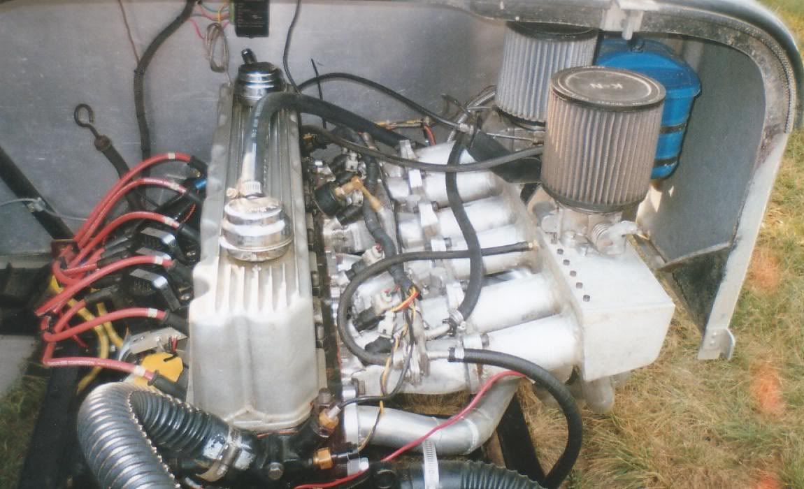

http://www.extrudabody.biz/servlet/the- ... 5mm/Detail and http://www.twminduction.com/ThrottleBod ... dy-FR.html are two more options if you want to go that route. My set up
First 1.5 inches or so is a stock 93 inatke welded to a Weber. Then it goes to a common plenum with three stock 87-90 TB's. Section between the "weber" manifold an the plenum is a nice place to tune with spacers for runner length.
Same "weber" section with a different outer plenum section
You will need to come up with a good working design of your own to achieve your goals. I would be more concerned with the runner volume than runner length on that intake. Not to mention that any factory, clifford [except the weber one], or Offy intake forces the use of a header that has poor exit tubing bends. Just mu .02. Save your money----BUILD YOU OWN!

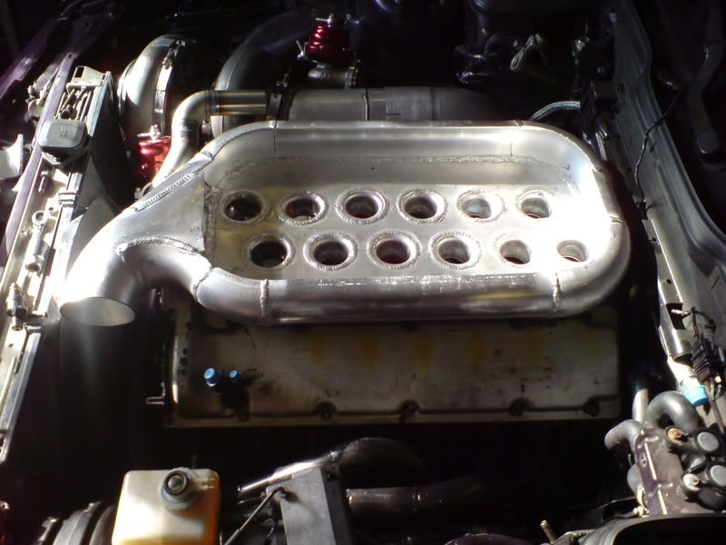

There's a lot of math and calculations behind it, but why not make your own?
(That's a BMW V12, but you get the idea..)

Which design works better? My guess is that 2 throtle bodies work better than 3. Were you running out of air with the stock intake? What size injectors are you running?SIXPAK wrote:http://www.extrudabody.biz/servlet/the- ... 5mm/Detail and http://www.twminduction.com/ThrottleBod ... dy-FR.html are two more options if you want to go that route. My set up

I run the Mopar 42lbers and according to the ECU they are at about 85% duty cycle. I am currently running the three TB set up and never have really played with the air door set up to try to optimize it. I made a couple of spacers to make the runners longer to taylor it to a lower RPM[not in pic]. The spacers for increased runner length helped the stall and low end without affecting MPH. I do plan on putting dividers in the plenum and restricting the tb's with some reducers that I have already made.
The old two TB set up had too large a diameter runner, too long, and too much plenum volume. With that intake there was a noticable drop in low end torque due to slow air speed. I believe the intake tune length was way out of line with the cam and header tune length. Even if I changed the cam and the header to match the intake, the ports in the head were never going to support that kind of RPM.
