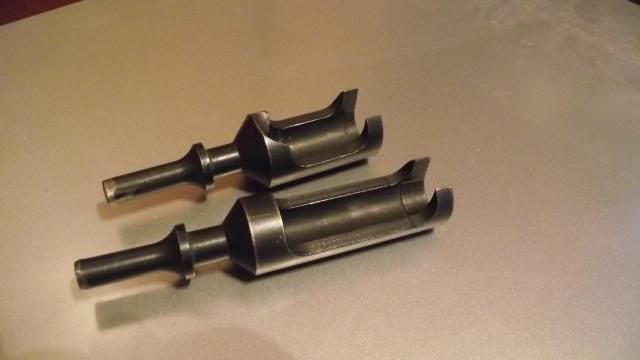

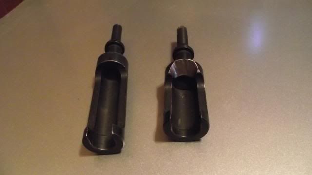

A lot of paranoia here!?? as I said I've installed a whole hand full of AMC six tubes, a GOZILLION!!! Chivy tubes and probably a ton of other press fit tubes and NEVER welded a single one!, I beat every single one in with my tool (I have two, one for 5/8" and one for 3/4") purchased under the "PIONEER" parts line and a ball peen hammer.
They're made to use with air hammers?, never done it?, didn't feel the need to snap a pump off!??, the 3/4 one needed to be relieved a bit for the tubes used with the GM 4.3ltr aluminum 4x4 pans.

Re: Oil pump pickup
That's great, but they cost around $85. That's a lot to spend on something that I'll probably only use once. Hopefully.
For $5, you can get this:
http://www.mcmaster.com/#6436k15/=o1o7df
And bang that sucker with a punch.
