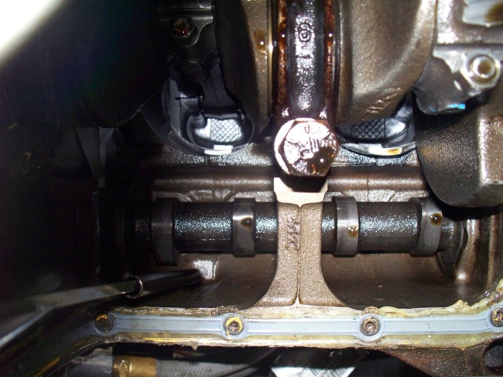

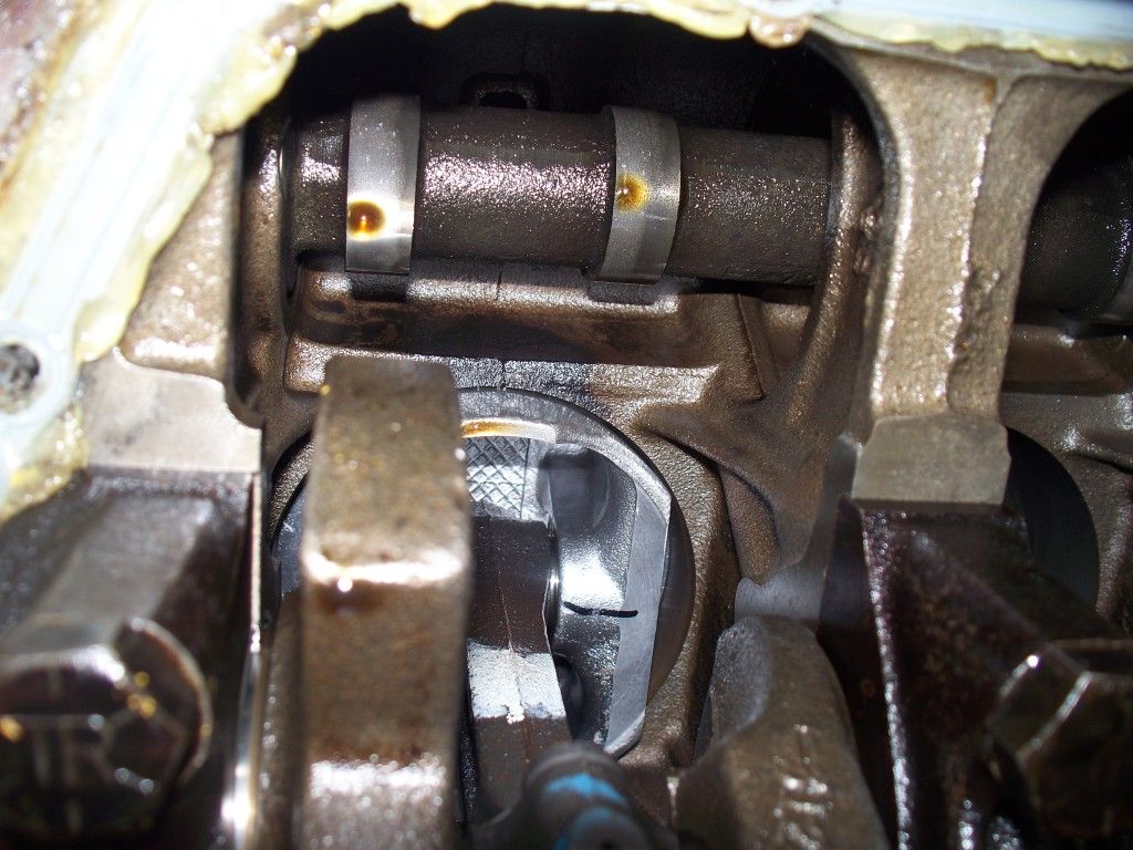

But yous humps is alright. There is a lot of knowledge to be shared on this site. I used break-in oil additive by comp I believe. This is probably the best shot of the skirts and cylinder walls, but after I gave up on the hacker's solution, I stopped driving it until I got the ftc1 hooked up

The cam wear looks uneven to me, but the engine has literally a couple of hours on it. I think I will probably want to put more break-in compound in when I get it back together.
