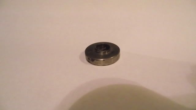

Save the harmonic balancer to make a spacer so your pulleys will line up correctly. That is assuming you have the more common long nose 258 crank.

Apparently the 258 oil pan can handle the high-volume oil pump without needing to be "clearanced". I did the spacer out of the 258 balancer: paid $15 to get the old balancer shipped to me and $20 to the machinist to make it--shoulda just bought Hesco's.

thanks for the advice, i have actually already done both. ;) anythin else? and like i said if YOU need anything off of it your welcome to it.

It's easier to just whittle the end of the crank off.

how do you "whittle" steel?? The only way i would have to do something like taht would be a grinder and my machinist says it would be double the cost of a Hesco spacer for him to do it.
Re: 258 salvage.
Stick it in the lath and "WHST!"
