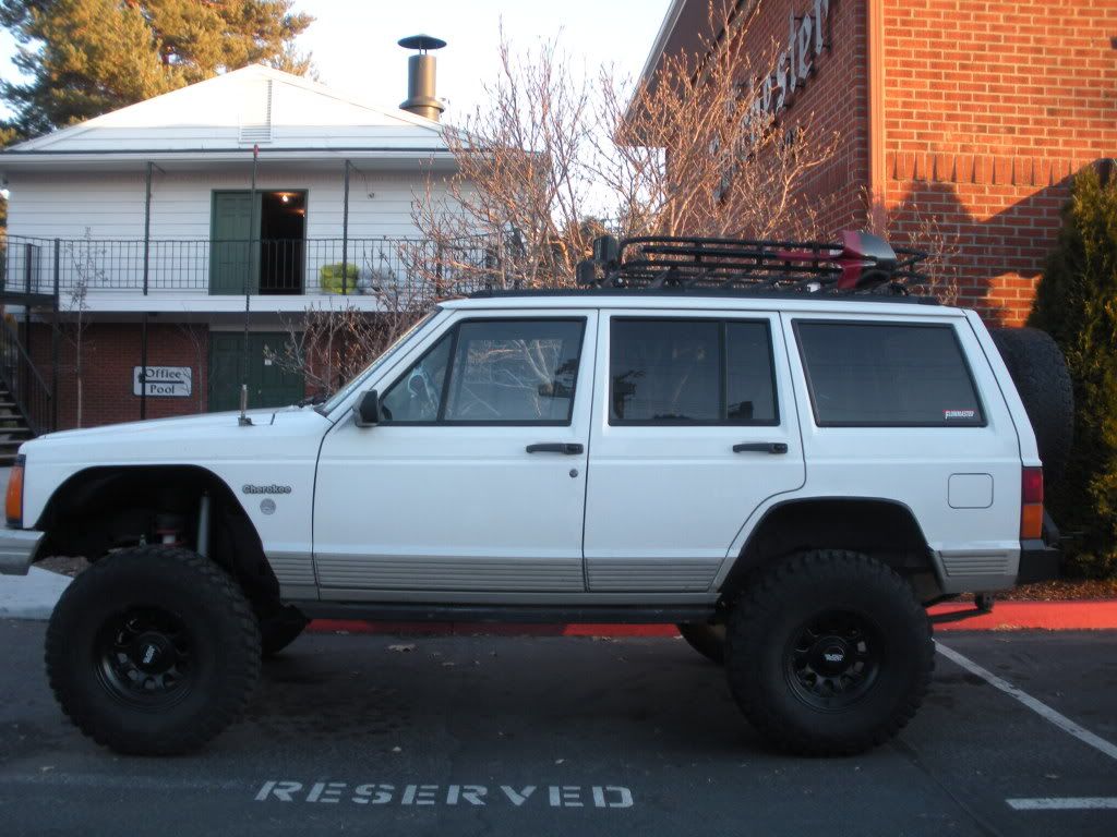

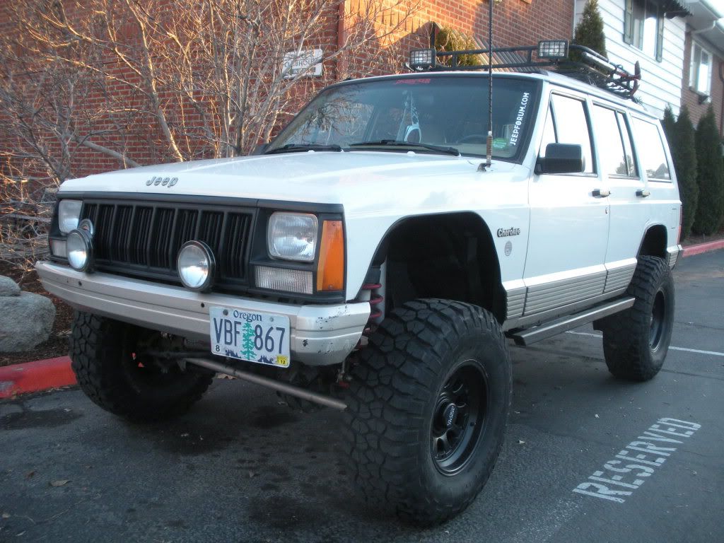

Also Just for fun here is a couple pictures of my rig. Her name is Jessie
