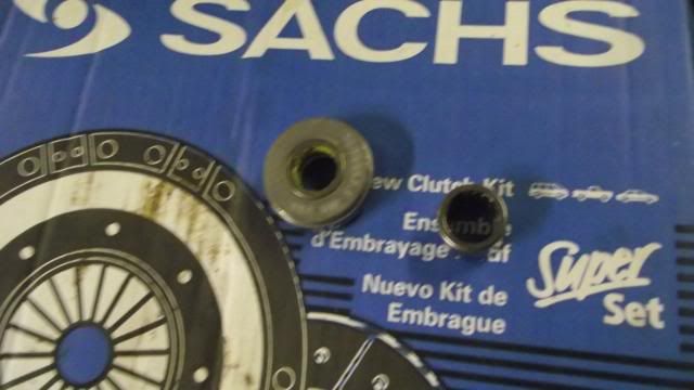

Apparently not?, the clutch kit I got for my Wrangler came with two pilot bearings?, I'm not going to stuff one in the crank until I get the thing apart to see what I really need?

are both the outer diameters of those bearings the same?

vashxj wrote:are both the outer diameters of those bearings the same?
NO!
