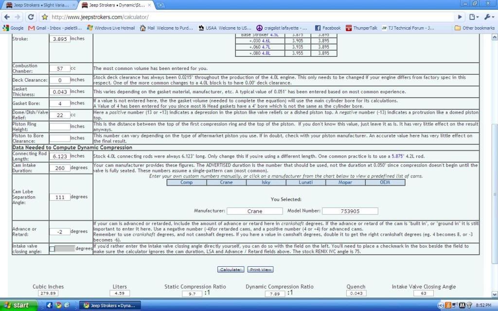

This is what I'm thinking. I'm trying to run on 87 octane and have ~260hp and ~325tq.
Any opinions or recommendations are welcome!

With That DCR you might b able to. I have 8.29:1 and I have to run premium unless I run it rich at WOT.

SilverXJ wrote:With That DCR you might b able to. I have 8.29:1 and I have to run premium unless I run it rich at WOT.
Thanks, this will be my first stroker and the learning curve is pretty steep.
Do all of my numbers look correct? I'm not sure about the 58cc?
Thanks
Re: Slight Variation Rockcrawler Option 2
I cc'd mine and got 57.3 after a polish job.
Post by gradon »
If you don't measure the cc's, be safe and assume they are 57cc instead of 58cc.
x2 I would go with 57 as mine were 57.3 AFTER polishing.

SilverXJ wrote:x2 I would go with 57 as mine were 57.3 AFTER polishing.
Thanks, so.... should this run on 87 octane?
