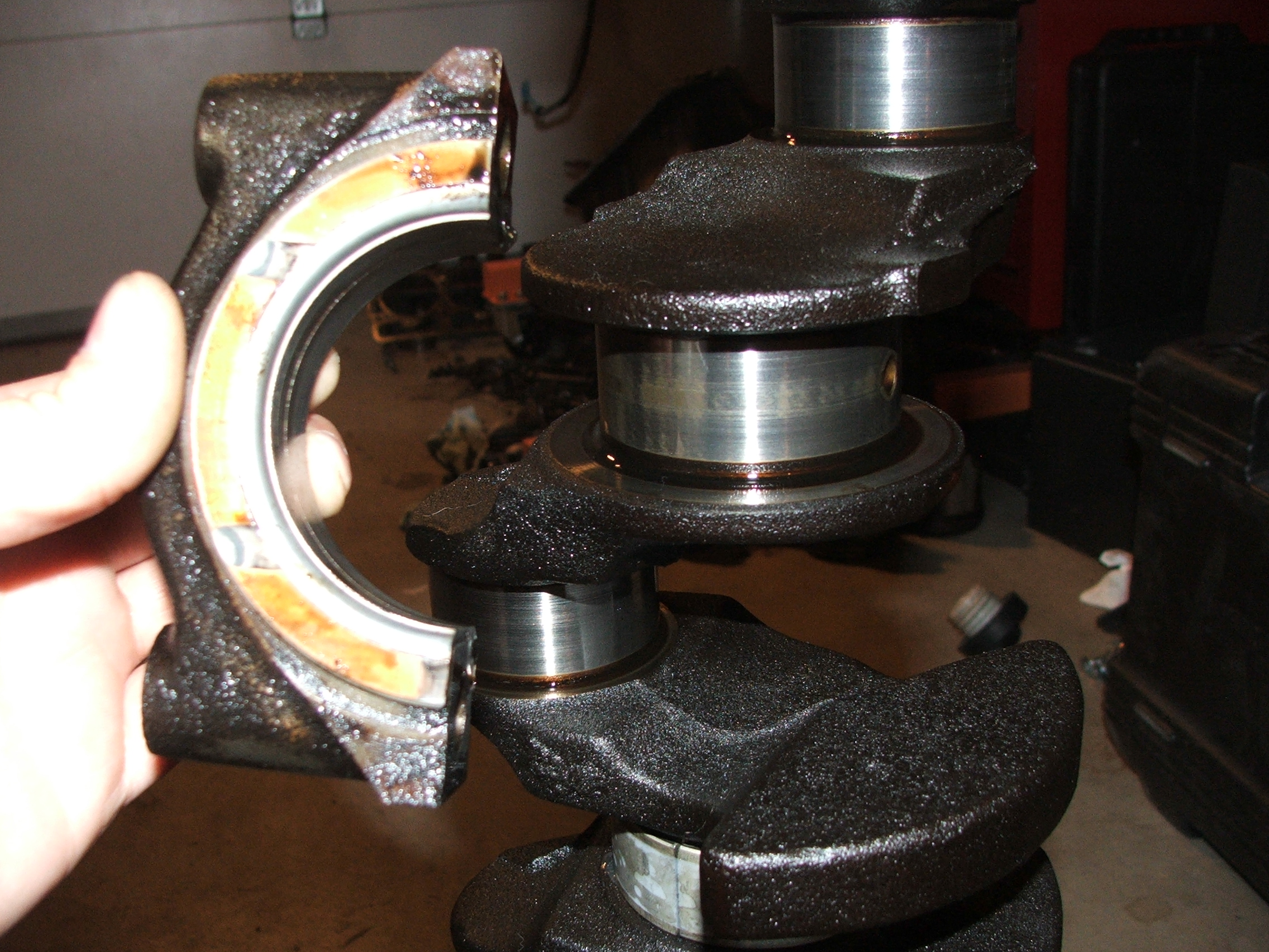

Pressed Main Bearing??? WTF?
- Muad'Dib
- Posts: 1516
WTF is this?? Is it going to force me to look for another crank?

not sure if i see the problem...... maybe i'm missing what the question is, but i don't see anything abnormal there....

When everything is cleaned up, and new main bearings are at hand, they will press on with thumb pressure.

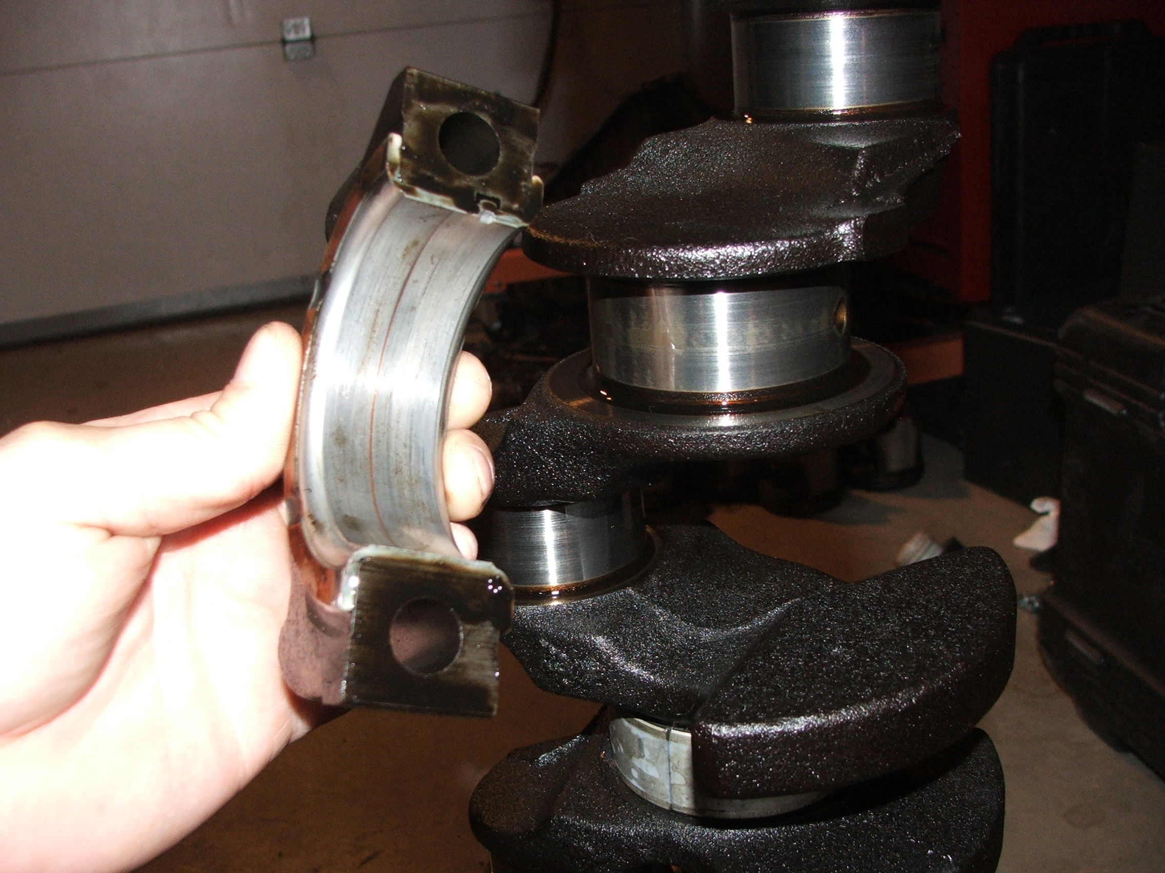

The bearing halves should pop right out if you fiddle with them.

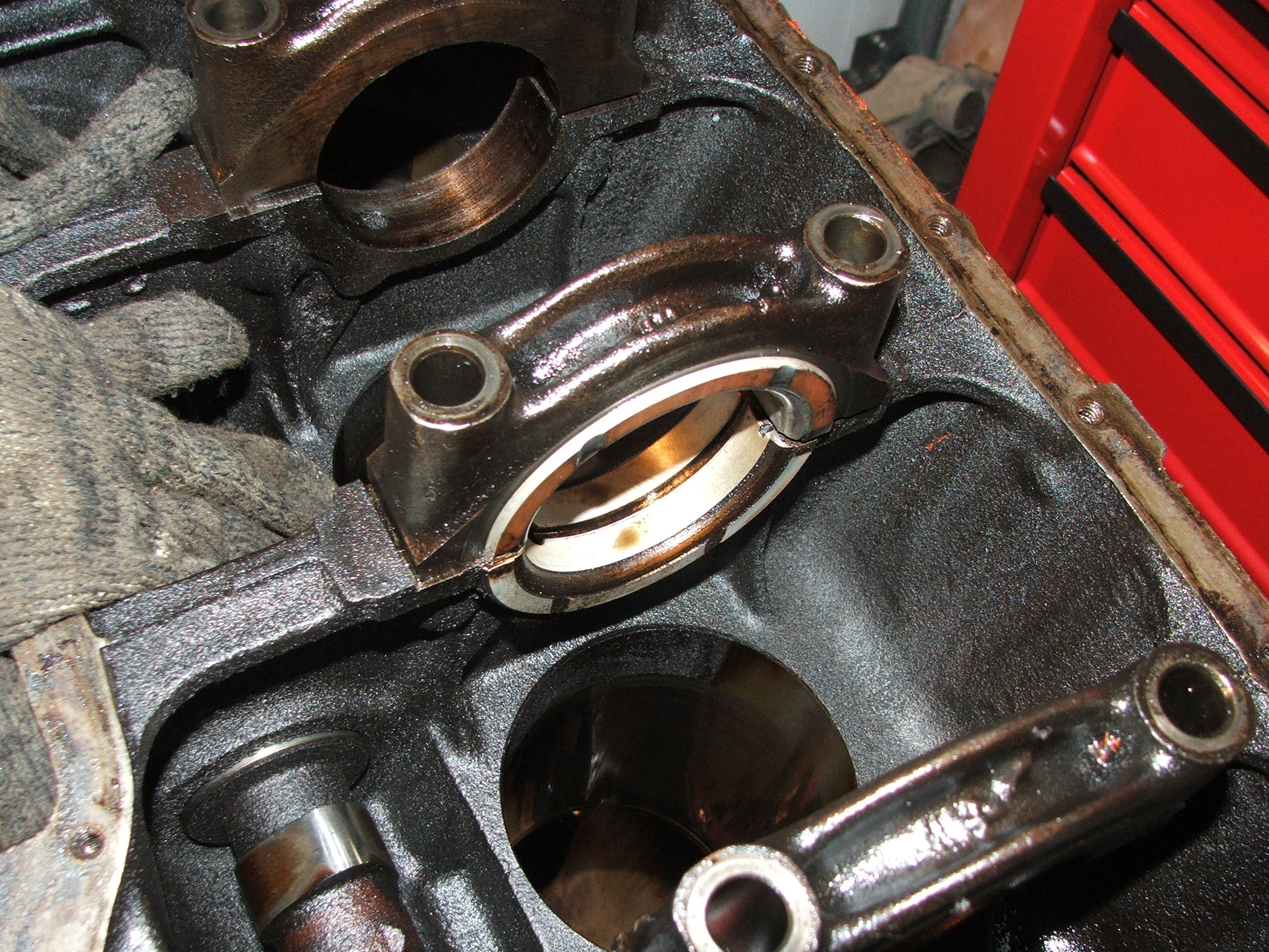

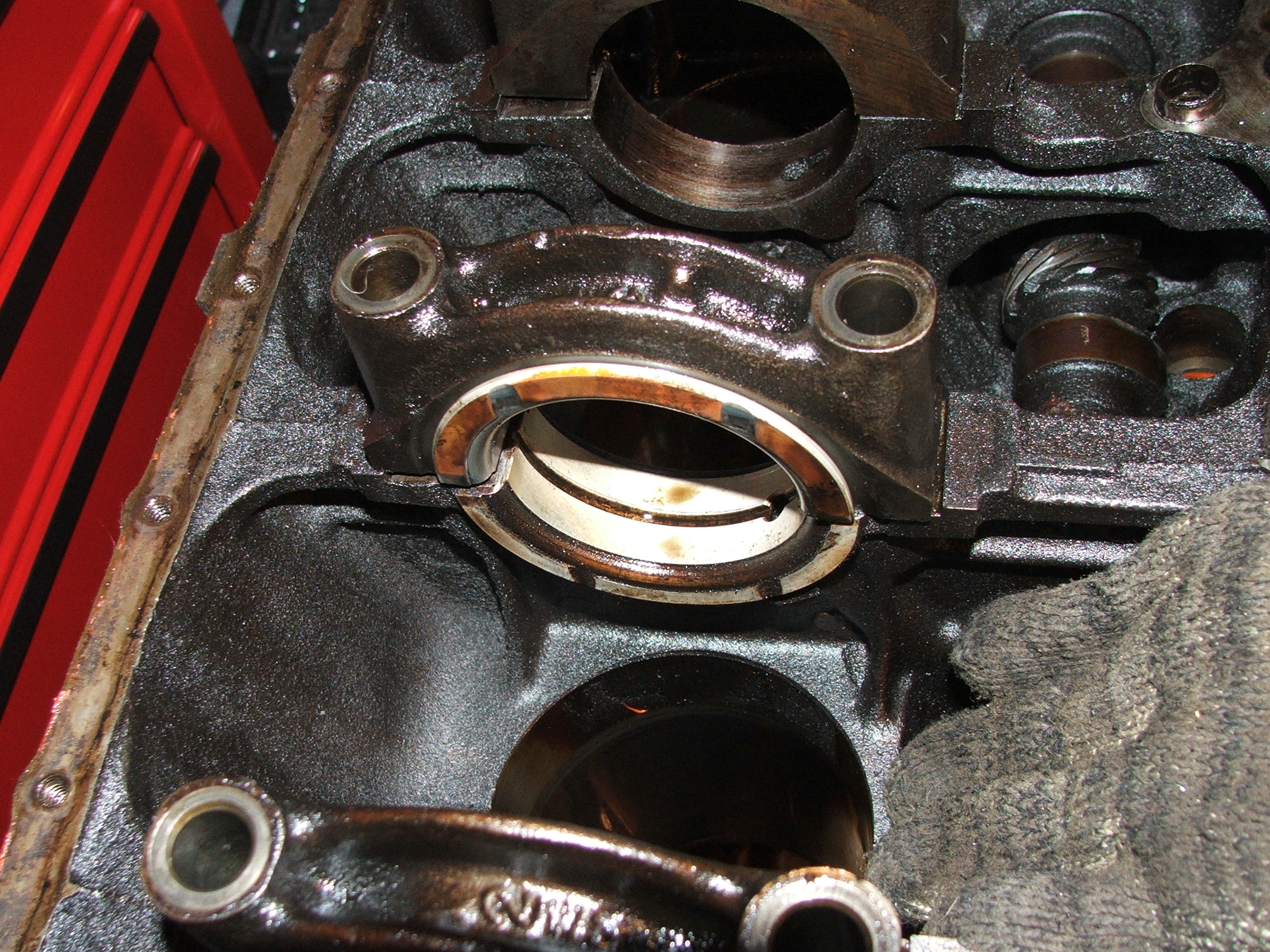

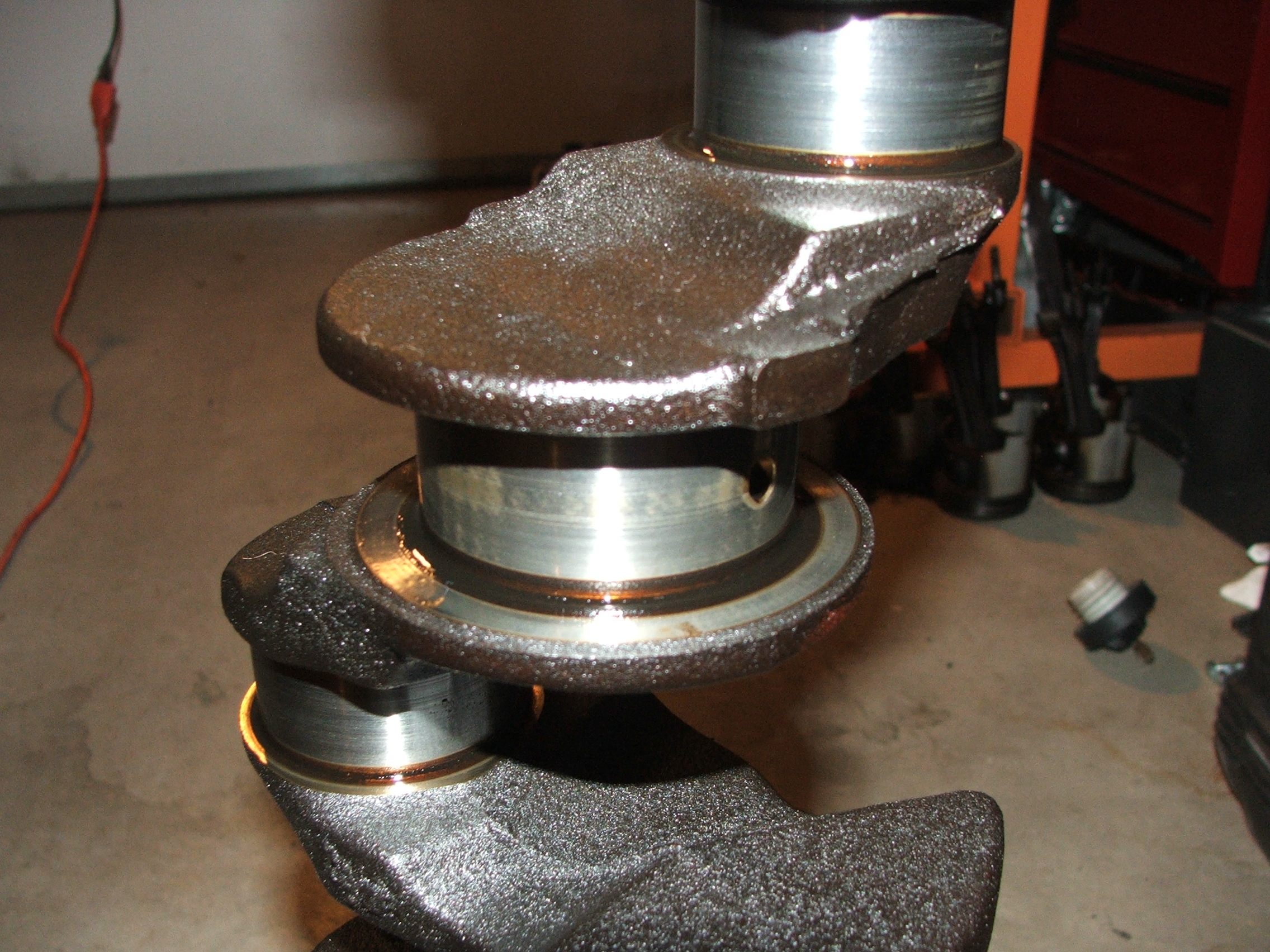

So all 258's have this as the #3 main bearing? Its completly different than all the others. You can even see on the crank itself that this journal is much larger than all the others... I guess im just that much of a noob to where i dont know that its something normal!!
Re: Pressed Main Bearing??? WTF?
I don't see a problem either. That is the #3 thrust bearing, its what keeps your crank where it should be in the engine in regards to front and back.. The 4.0l has one as well.

i asked the same question after i took apart my 4.0 and 4.2 side by side. didnt dawn on me at all, even after taking both apart. i asked elsewhere thinking my block was bad or maybe my crank. totally normal.

thats the thrust bearing. controls front to rear movement of the crank
