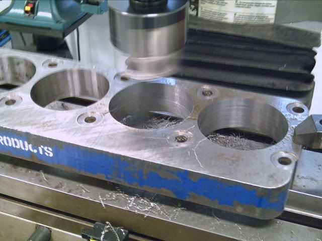

TT should be posting some results of his bore dia before and after the plate was installed. I think it will end up pretty interesting. Maybe we can get him to post the results in this thread also.

I should finish the valve job tomorrow, that will free up the mill so I can modify the T/P as Sixpak requested. I will post the results of any bore changes as soon as I can.

Here is a picture of the plate. The shop is closed until next Tuesday ( gone to the races), so the numbers will have to wait until then.
But I will give a detailed review.
