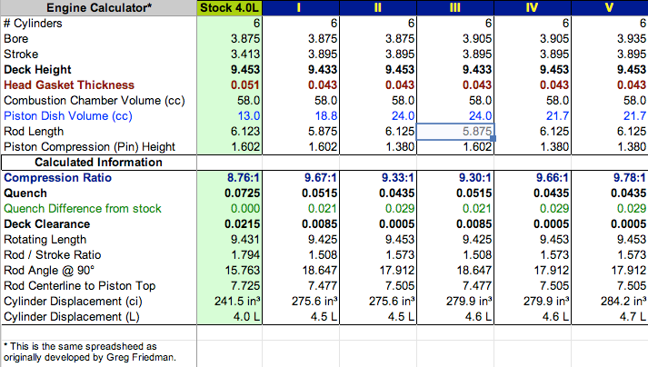

Just a few set ups I'm playing around with, internally that is.
I 4.5L, stock bore, 4.2L rods and crank, Sealed Power 677CP standard bore pistons, block decked .020", Mopar/Victor 0.043" head gasket
II 4.5L, stock bore, 4.0L rods, forged pistons with 1.380" pin hight, 4.2L crank, Mopar/Victor 0.043" head gasket
III 4.6L, bored .030" over, Hesco Forged Pistons, 4.2L rods and crank, block decked .020", Mopar/Victor 0.043" head gasket
IV 4.6L, bored .030" over, 4.0L Eagle forged rods, Keith-Black Silvolite UEM-KB944 +0.030" bore forged pistons with 1.353" pin hight, 4.2L crank, Mopar/Victor 0.043" head gasket
V 4.7L, bored .060" over, 4.0L Eagle forged rods, Keith-Black Silvolite UEM-KB944 +0.060" bore forged pistons with 1.353" pin hight, 4.2L crank, Mopar/Victor 0.043" head gasket
Oddly I'm leaning toward the 4.7L as machining will be free, and the pistons cost about the same.

I got the pin height wrong for the Keith-Black pistons, it's actually 1.353" instead of 1.380" like I thought, alowing me to mill the block that .020", but I'm still coming up with 9.64:1 CR. So I may play around with a combonation of decking the head with a differant sized head gasket to get the CR up where I want it. I'll fix the chart when ever I get internet at the house again, stoopid AT&T :banghead:!
I'm still pushing for a 9.78:1(ish) CR with a 4.7L. I'm still unsure if I want to go 4.6 or 4.7, I can't seem to find specs on a long rod 4.6 yet, and it all comes down to how much power it makes, and what RPM it makes it at. Once I start playing with the software at school, and can get some "dyno" numbers, I'll have a better idea.
