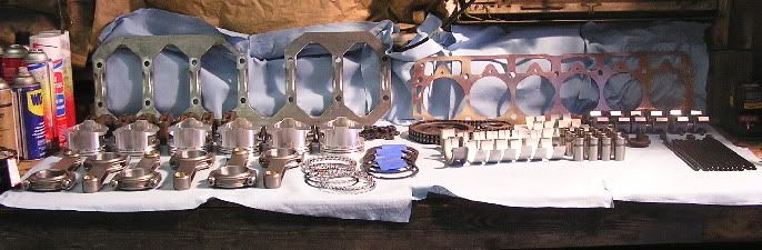

Sure I'd be happy to elaborate on my Turbo build.
I used to have a website but it got to be to much trouble to keep it up to date and I wasn't getting much business off of it so I let it go.
This is the only pic I can find of the girdle rite now I'll look for some more of it and the pan. I had to build the pan to go around it. It is 3/4" thick and is machined out to fit on top of the main cap bolt surface you can see it in the pic if you look hard. Sorry for that pic but it's the best I can do for now.

You definitely don't need to look hard to see that! Is that a copper head gasket? If so, where did you find one? I looked in the past and never did find one.

Yes it is. I have them made for me.
