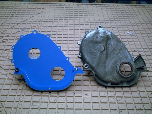

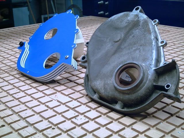

I machined a back cover prototype out of plastic I had here. I will use this material for designing the drive before I start with the aluminium.
Here are a few pics of the beginning stages...hot off the ShopBot

veeeeery interesting :-) I love watching custom stuff like this come together.
What would you plan to use for a crankshaft seal? stock lip seal or something special?

TurboTom wrote:
Yes it is tight but I believe doable. I plan on taking both cam designs in account, But will have a thrust bearing for the older design.
It looks like the older blocks used a different bolt pattern on the timing cover, I think they changed in 92 or 99, not sure. If you buy a gasket kit, it comes with 2 gaskets.
What dimension did you get for the centerline of the cam to crank? I came up with X- 3.75 and Y + 3.375 using the crank centerline as the origin. This was just using calipers, maybe you have a better way to measure it. I could not find any standard belts or pulleys that would work with the center distance. You will probably have to use a roller to hold tension.
