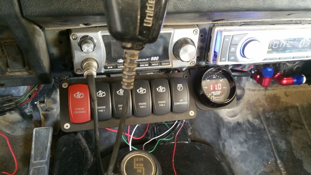

I am running rich on idle, but when I get some revs going it starts running a little lean.
10-12:1 at idle, 15-16:1 @2000 rpm

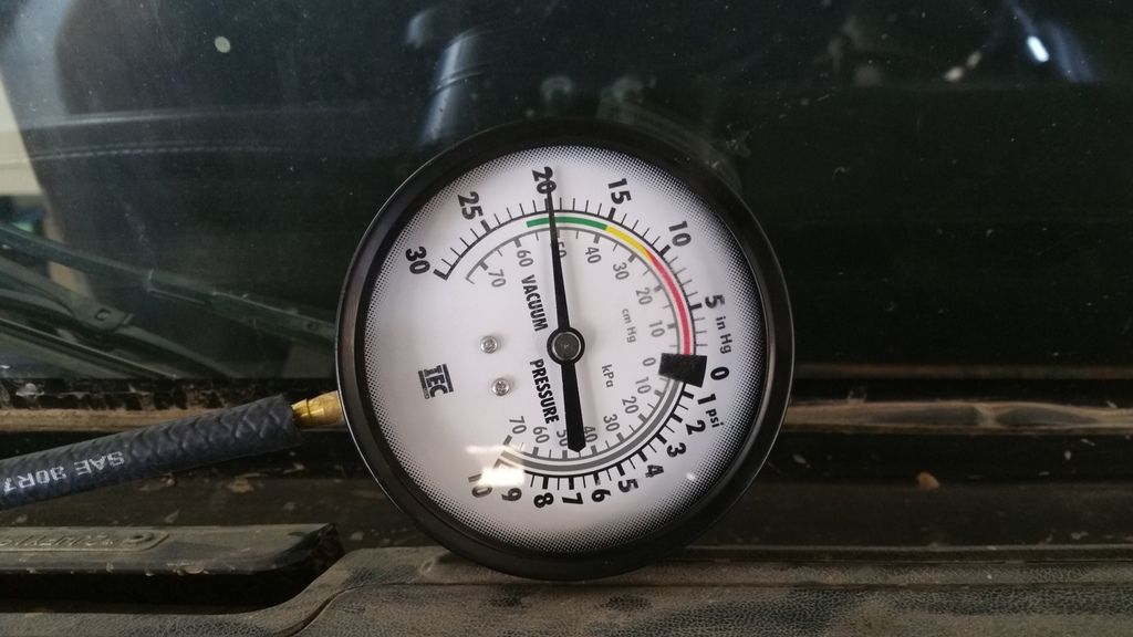

Initially had this problem with some lifter noise, ran a vacuum test and it was jumping from 12-19 in-hg. Ran a compression check and got #6=0psi, 1-5: between 165 and 175psi. Removed the rockers on #6, pulled the push rods, cleaned them, put the rods back tapped on them with a soft mallet to free them, ran a compression check and got 170. Put it all back together, everything ran a lot smoother, still has a little tick. Ran a vacuum test and it holds a steady 20 in-hg.

Measuring on the summit wide band aft gauge.

Idle vacuum was at 18 in-hg, @ 210
Needle bounced slightly (17.5-18.5)
@2000 vacuum goes to ~23 in-hg

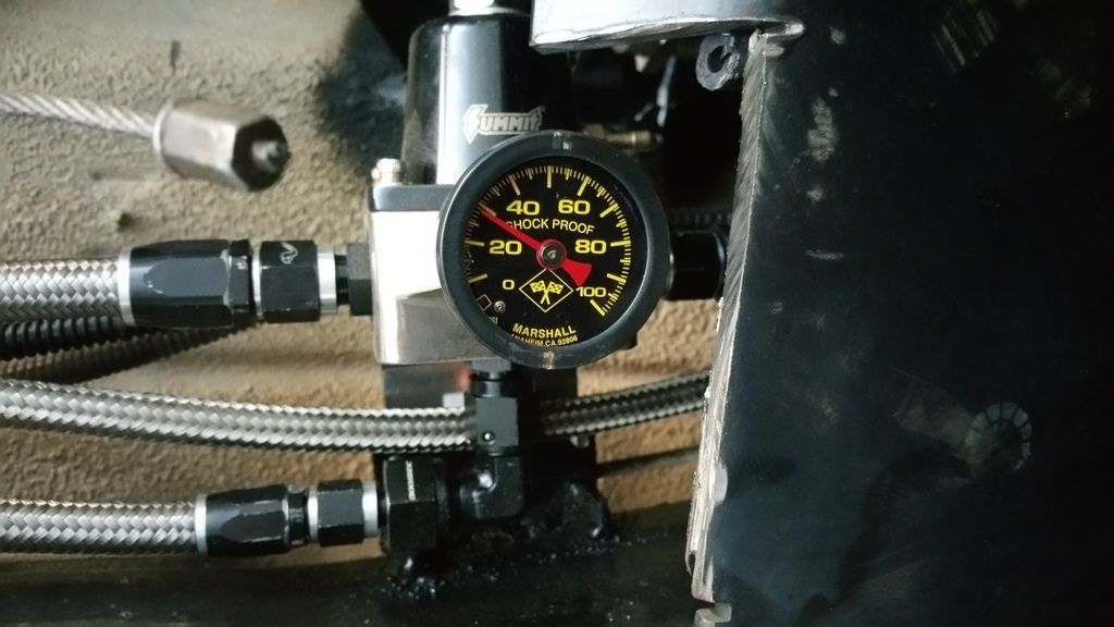

You said your fuel system was a custom AN set up. How about a picture of that ? Can you verify the return line is in fact returning ?
Johnson Hy-Lifts are your best bet. Get in touch with Russ Pottenger for a set. He is on this forum a lot and his contact info is in his sig.
Once you get the lifter business straight lets try again.
