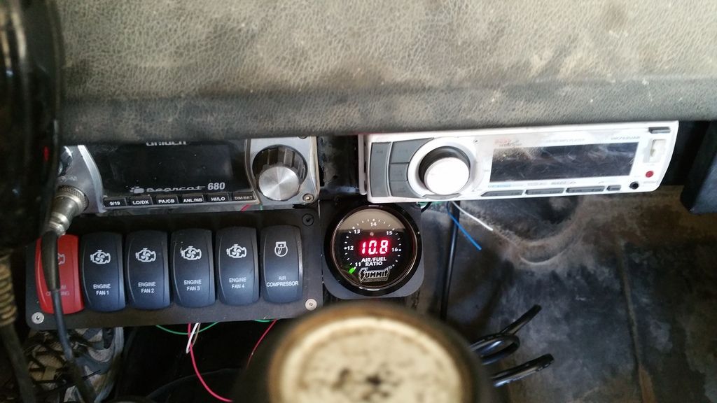

I have a 4.7 CA smogger, running 55 psi on the fuel rail, with 30 lb injectors, 2001 intake, 2.5" exaust, header, comp cams cam, 4.2 crank with 4.0 rods setup.
Any info would be appreciated.

You didn't read my post of JF. Go back and see it.
Re: 4.7 running lean
That gauge is showing rich. Why are you running 30 lb injectors? Those are way too big.
Also, more details needed.

spjewell = Your confusing lean with rich. less than 14.7:1 is rich higher than 14.7:1 is lean.
