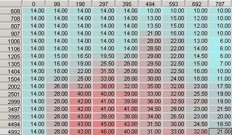

chris is that a stock obd1 sbec2 timing map?

yes, that is a stock SBEC2 timing map.

is there any variations in the timing map between the sbec 2 ecu models? or the timing is all the same?
i'm asking this because i have 3 different jeep sbec 2 ecu's and they are not all workings the same.
and if so can you please post a pictures of the maps.
those timing maps can really help us AEM FIC users to know what the stock ecu is doing.
