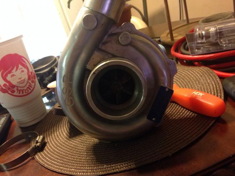

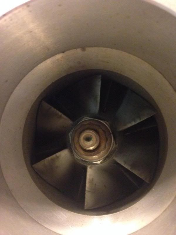

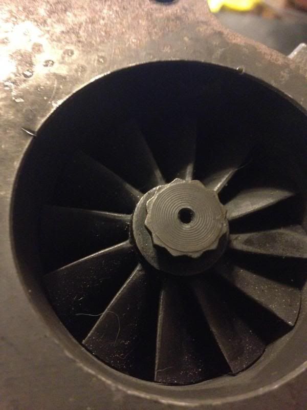

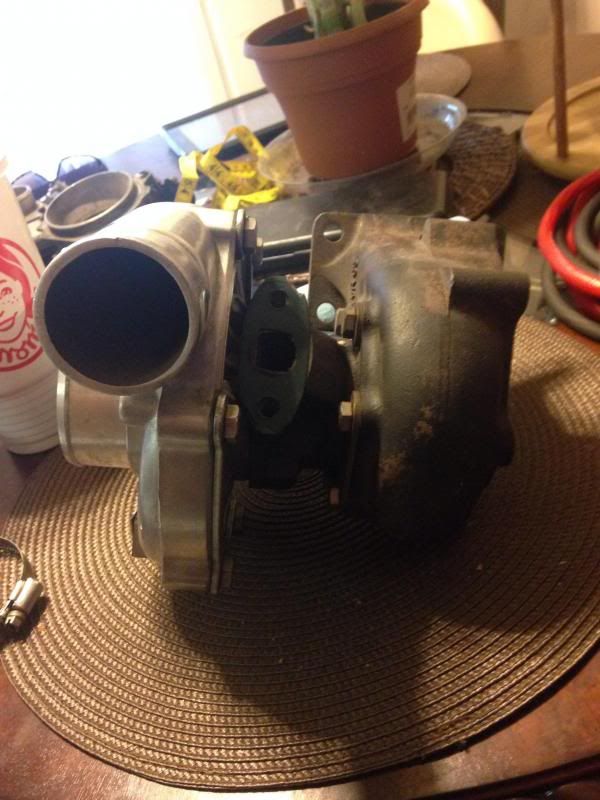

Some more specs for you guys. I believe my compression is 9.05:1 & 7.9 dynamic with a .033 quench height. Running a mopar 229 cam with 1.7RR's. There's a unknown piston dish so it could be even lower..but that is the highest it will be. Pistons are cast speed pro 677's.
I believe I'll be good for my 5-6psi I'm actually after. It would be locked in on a 5psi wastegate spring.
Intake: 3 inch
Inlet: 2 inch
Compressor trim: .50
Compressor Wheel diameter: 50.16 / 76.84
Turbine Wheel diameter: 54.06 / 65.20
Exhaust Trim: .63A/R
Just picked it up. Yes its a knock off GSP (Godspeed) brand that has been rebuilt and spec'd. Saw mid 300hp on a honda series motor.
Grounding kit and anl fuse holder in the back ground waiting for the jeep as well. :cheers: and the 80mm vortec tb I'm hoping to graft in as well.

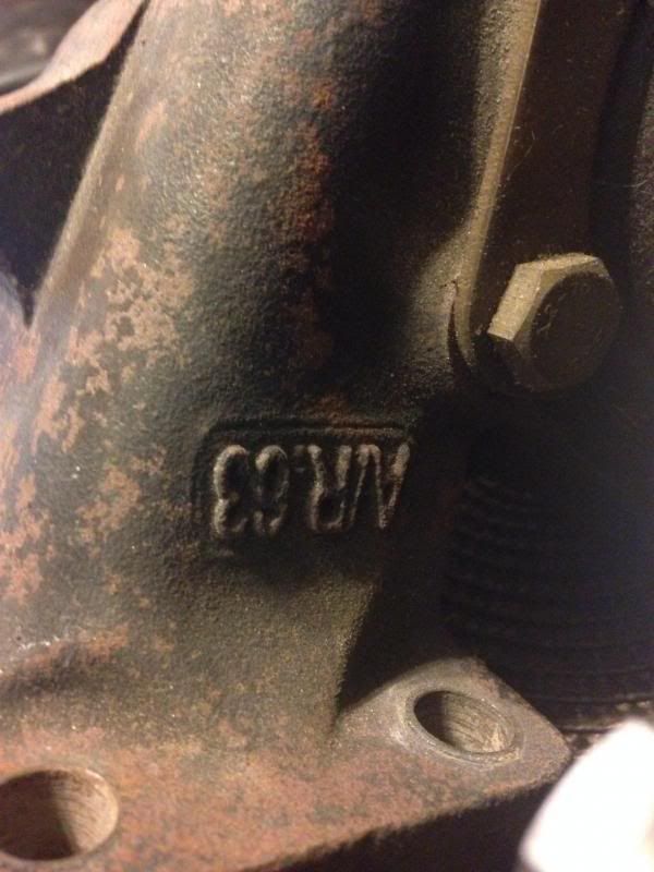

.63a/r & its a 50 trim. Not 63 as advertised? Being a 50 trim it'll be about perfect..I wish it was a 57trim as the others using a 50 are spooling at 17-1900rpm. My cruise is 2400 @ 65mph. 4.10, 31s & ax15.
No play anywhere, nothing loose. Ran for 18000 mile before the setup changed. 0 miles on the rebuild.
