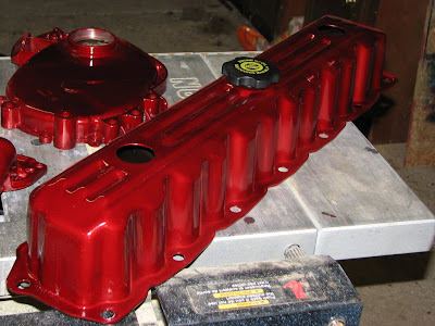

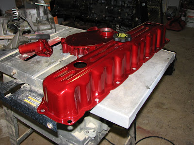

Ok here's where I am so far. 4.0 is all torn down and block, crank, pistons, rods and head are off to the machine shop. Starting to clean up all brackets and parts, some are already cleaned and painted. We (my 16 year old son and I) decided to go with a candy apple red paint for the parts and I have to say it looks pretty nice. Long way to go but as stated we're taking our time!

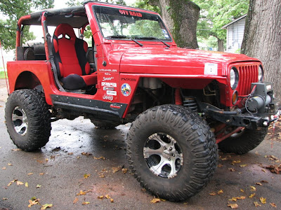

Here's the Jeep it will be going into:

Nice color...I love it when someone has the courage to paint boring parts (timing cover, valve cover) something that isn't boring...It looks great. I, however, will be sticking to black and silver, as I am obviously a coward... :huh: The Jeep that gets the transplant is a sweet looking ride...I love the flat front fenders, and Ican't wait to see the red under the hood when you are finished...it's going to look great...

Thanks, I just had to do something with it! As the Jeep spends most of its time playing in the dirt and rocks it will probably only look good on the stand, as soon as its in the Jeep its probably going to get dirty fast!! I'm taking my time so this gives me something to do while I slowly build it up. It's amazing how long it takes to hand clean all the parts :P
