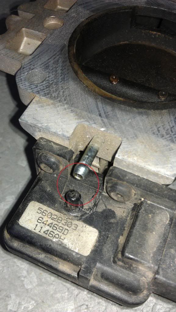

It was the 'very little' rubber line, not visible without removing the throttle body, from the base of the throttle body venturi to the underside of the map sensor.
When removed, I couldn't get above 3000RPM & the engine pinged really bad.

Well, I took the MAP sensor off and everything appears to be in working order. The little 90 degree right angle vacuum elbow is in near perfect condition with no visible cracks. The suction around the seal was tight to pull the MAP sensor off from the throttle body.
What are the symptoms of a MAP sensor that's not getting a correct reading?
