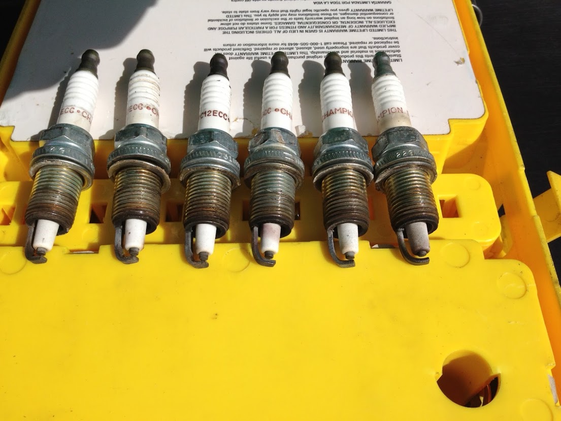

I just finished the 1700 miles after I got it first installed. Initially it was working great but in the last 300 miles it started to have issues and threw misfire codes. For the break-in I had used Champion Plugs RC12ECC at a stock gap of .035. I think it started to throw codes after the rings seated. I just switched to the NGK ZFR6F-11 with a gap of .044 (I had to gap the plugs again when I got them, they came as .040) and reset the OBDII. I just ran the truck for a day and it just threw a code (haven't read it yet). Any ideas on what the issue could be?
Here are the images from the Champion plugs:
(Top plug is the cylinder by the firewall)
(Far right plug is the cylinder by the firewall)

If you get a misfire code on the no.6 cylinder, the reason could be a faulty coil or faulty plug wire.
Re: Jeep Stroker 4.7L
That # 6 plug looks pretty bad, especially with that low miles.

Should I consider replacing the coil rail or just trying another set of plugs?
Also, I just remembered that the 6th plug was actually borrowed from an older motor since I broke the newer plug I bought for that cylinder. So it looks a little worse for that reason.
Posts: 3283
Drv2e30 wrote:Also, I just remembered that the 6th plug was actually borrowed from an older motor since I broke the newer plug I bought for that cylinder. So it looks a little worse for that reason.
Mmmm. You could have mentioned that little detail in your first post. ;)
Just replace that plug with a new one and see if you still have a misfire.

My apologies, here is some additional information for you:
ORIGINAL CHAMPION PLUGS (Shown in Photos) - [RC12ECC at a stock gap of .03]
-I had these plugs in the engine from when I first put it in after receiving it from the machine shop
-I about 1400 Miles in I started to get Misfires on cylinders 1 and 3
New plugs installed at 1700 miles with the new engine.
-NGK ZFR6F-11 with a gap of .044 (I had to gap the plugs again when I got them, they came as .040) and reset the OBDII
-After about 300 miles I got a misfire again on cylinder 3
-I plan on pulling the 3rd plug this weekend to check what it looks like.
I think this may be due to the fact that my coil rail is currently held in with zip ties. I think I'm going to do SilverXJ's viper pack upgrade to reduce the possibility of the plug not getting the spark it needs when the road gets bumpy.
