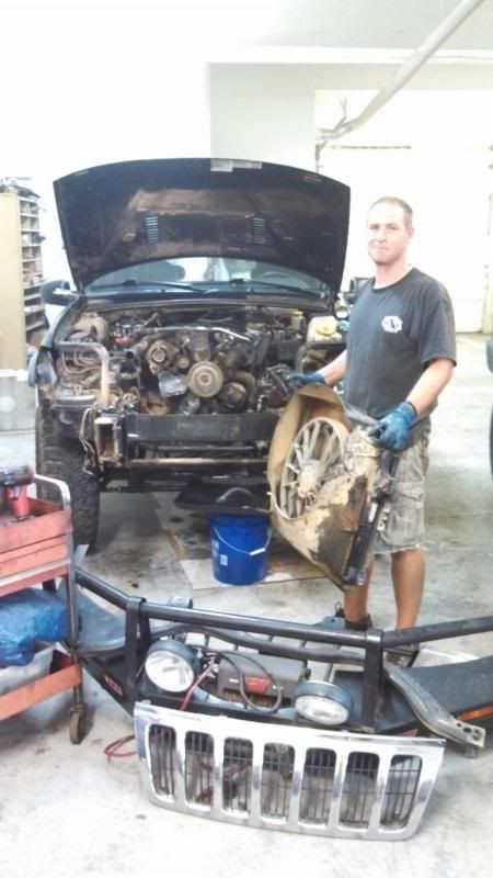

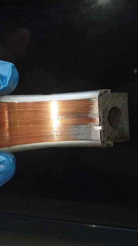

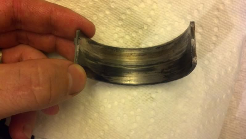

Some of you may remember my build Simple/Budget build of a few years ago: http://www.jeepstrokers.com/forum/viewt ... f=15&t=607. Well after battling some oil pressure issues, I pulled the oil pan and found the bearings were trashed. Guy looking at my crank/bearings said something about oil contamination or possibly a bent rod. Time to tear everything back down try again. Hopefully I learned some things from the first go around, and there are some areas I'm trying to improve on this time.
I've got everything torn down and currently looking for a machine shop in WNC that can work on the block. The two shops I used before have since shut their doors or no longer performing the work. The plan is to have the deck machined to get a better quench and higher compression. Lots of room for improvement there. Also planning to have new cam bearings and freeze plugs installed while its in the shop. My stock cam/lifters still functioned fine (no ticking), but at +150k miles I'm debating swapping them this time. Any suggestions on a cam choice for off-road & torque?
Let the fun begin!

How many miles did you put on it since your rebuild? I'm wondering what kind of bearing clearance you were running. An improperly polished crank can eat bearings like that also.

Less than 10k miles on it. I know it was plasti-gauged and said the bearings checked out ok. Not sure about the quality of the machine work...I bought the crank from an "engine shop" on ebay.
