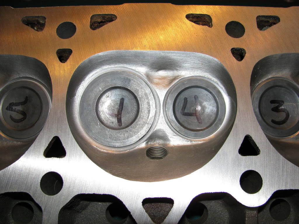

68cc is possible with the head.

TR1Hemi wrote:Image
Bingo, and Chris my motors not running yet. I'm trying to figure it out before I get it back together. Or were you referring to the 4.6l build I linked?

TR1Hemi wrote:Image
Are you not worried about the shape of the chamber at all? I thought the offset shape of the chamber by the spark plug was to promote swirl? Yours is completely gone?
The provision opposite the spark plug wasnt in Hescos aluminum head, so I'm cutting that out. Same goes for the actual "ramp" or "angle" of the chamber walls. My last head I ended up dropping that angle down some, the walls weren't as steep as a stock chamber. Good or bad?
I also shaped the radius of my chamber quite a bit. On the side of the head where the chamber starts to open up around the edges of the valves. for am easier reference, you could say around 10 o'clock, 2 o'clock, 4 o'clock & 8 o'clock position. I shaped/opened that area a bit, made it more open/wider and smoother radius vs the stock closer/sharper radius. Any advice on this?
The general rule here seems to be don't change the port shape, yet slowly more info is coming out on the chambers and what people are doing to theirs. How they are picking up size and what they are doing. My valves gain me 1cc all together. I'd like to get around 64cc chambers. Currently 57.7-57.2 all untouched, with my valves its 58.5 roughly.

Oh I'm with ya, a easy 100 bucks in stones and papers and 1 carbide bur down the drain on the first head. On your head it appears around 3-5 o'clock & 9-7 o'clock there's a valley so to speak shaped around the valve? Is this what I'm seeing or my eyes playing games? Any tips on what you've done? It appears you just made the chamber on the quench side flat vs curved? And the opened up and made the ramp/angle slightly less on the spark plug side?
Of course deshrouding valves and such as well.

Yep thats pretty much it. I am at 2800' so this thing should run on the 85 octane cougar piss...lol...and still be fine on 87 when I head down do 600'. It may not work out, but at least everyone knows the metal is there to do it! BTW, this was a 720 head off of eBay.
