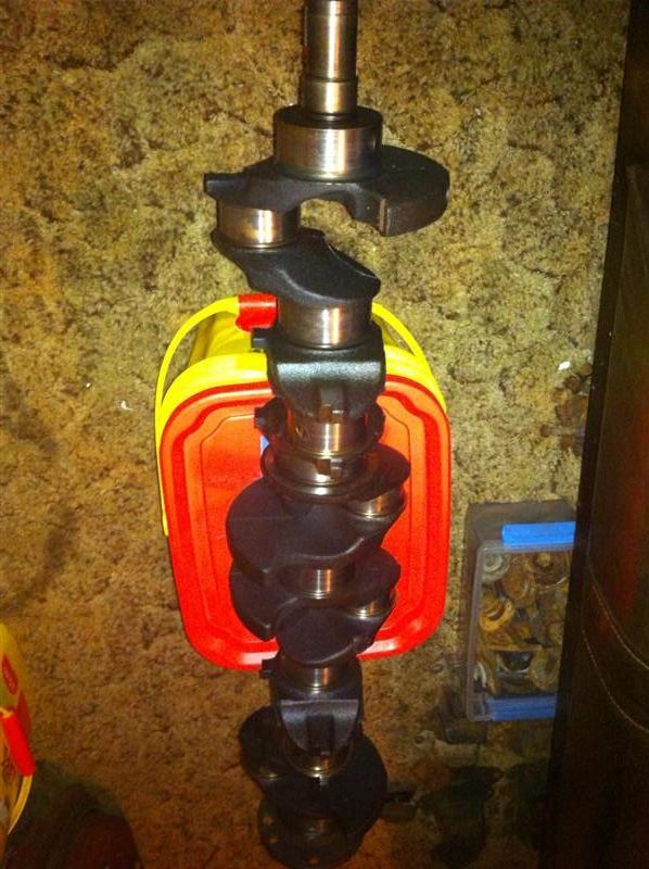

On another note, I received my crank and 707 rods from the guy I bought them from in Alabama. The box came all mangled from shipping but it was packed well and looks ok. However I think someone tried to chamfer the oil holes in the crank at some point, what do you guys think
Not sure what I'm looking at here, if I got screwed or not. The journals are otherwise in good condition minus those rust spots.

The crank is used, hoping you knew that. It would at least need a polish.

Yes I knew the crank was used and was expecting at least a polish/grind, does it look like someone tried to chamfer the oil holes? I'm looking at several options right now in descending "most likely to occur" order
1) 4.5L Low Budget with Standard Bore
2) 4.6L Poor Mans (keep stock head, replace as little as possible and run stock/mild cam)
3) 4.6L Low Buck or Low Buck Low CR more agressive cam
4) Rebuild as stock
I still need to price out each build and go from there along with pulling my existing engine apart and inspecting what components might be reusable (rockers, timing gear sprockets, camshaft, etc). I should have a list brewed up in a few days when I get some free time
4) Rebuild as stock
mikalcarbine
- Learning to use the board
- Posts: 38
- Joined: May 25th, 2013, 10:39 am
- Vehicle Year: 2002
Re: 4.0 Engine Toast - Considering Stroking
Going to break down my engine this weekend so a machine shop can check my block.
I noticed yesterday my head is 0331
I never overheated the engine but I'm very hesitant to put ANY money into this head. I'm not too sure what to do with it, I'd like to port and polish whatever head I end up using in the end. Should I break the entire head down and have it hot tanked and magnafluxed and then go from there? Would I be able to reuse stock components doing this or should I just let everything be and ride on it if the components are within spec?
