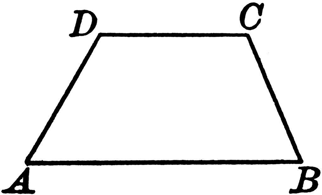

And not to start controversy but I believe 1bolt either mixed up his words or was wrong in a few cases, or maybe he found another way to pick up the flow, opposite of john. I spoke to John (nosigma) for advice this go around. 1bolt states to open the roof more than the floor. Seen in this quote here, "Eventually this was raised to 246 cfm with added flow at all lift values by widening the port with most of it occurring at the roof and then tapering down to the floor."
John stated the opposite. He said he pulled the ramp back and shallowed it a bit vs being so steep. He said that picked up quite a bit low lift flow. He also had wider floors than the roof, and his runner shape was almost a trapezoid shape. He said he opened up the floor and wall on the cylinder side more than the anything and picked up a great deal of flow doing so & that it promoted swirl.
So his ports looked something like this, except favored a bit more to the wall closet the exhaust port.
I'm kinda copying that but not so extreme. I pulled the ramp back a bit & opened up the floor & wall on that side slightly more, also most of the grinding down towards the floor vs the roof. John also said a very slight trench was added in his head, also on that side...about a 1/16 of an inch deep. I have yet and probably won't do that. But I figured I'd post this info for everyone to ponder on and give their opinion or thoughts.
