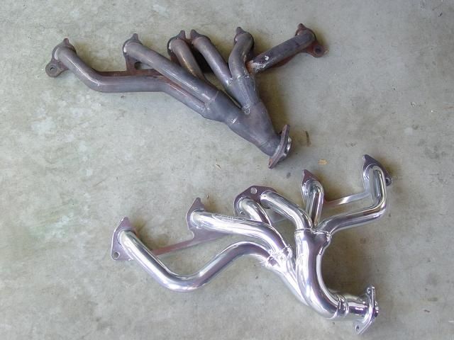

Also if a custom header isn't an option for me (gonna find out locally first) but if not then getting down into the Doug thorley which everyone claims in the "best" header for the jeep 4.0 has EXTREMELY short primaries which won't support low end at all. Now it does have the tri-y design which helps spreads the torque over a wider area but still..
Then there's the apn which can be had for under 150 to your door. Same tri-y design, primaries are matching 1.5" I believe as the thorley and seem to be longer. "Primaries" meaning first section of tubes. Or is the throley longer because the "secondaries" are longer? I've read ALOT of links on headers already..can anyone shed light here. Ceramic coating isn't an factor here as either would be coated.
Comparison of a banks(apn knock off identical) & a thorley. My thinking says the apn header is better performance wise because the longer primaries...I also understand not much will be gained either way, but I'd rather start out with the better of the 2.
