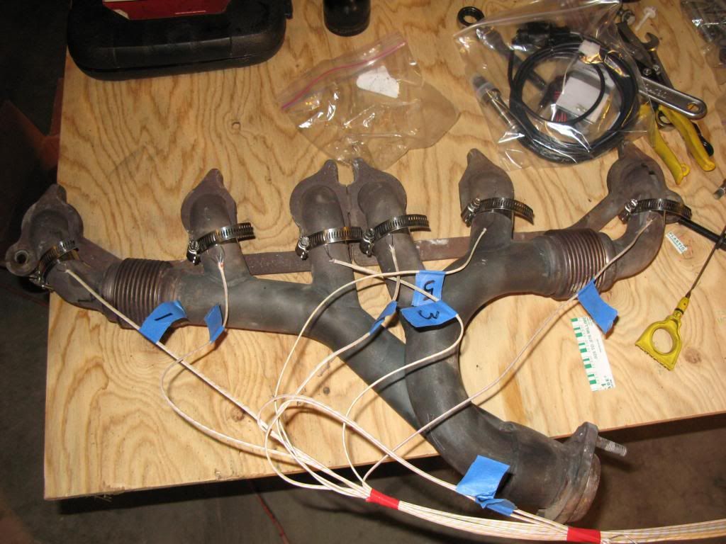

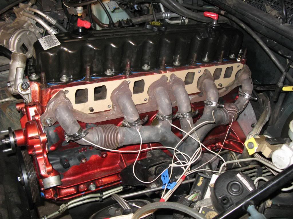

Here are some pics of the setup. Injectors 5 and 1 were swopped with no impact. We also switch 5 and 6 injector wires again with no change. This eliminates injector, wiring and electronics as potential culprits. There are slight differences in thermo couple locations so we will adjust to test for a change. We will also install one of the spare TCs and check for a faulty TC.

Ohhh.. the probes don't actually go in the exhaust stream? Not sure how accurate that setup is since it is measuring the pipe, not the gas. It would be interesting to see how that compares to an in pipe EGT probe.

I don't think there is a significant difference between gas temperature and outside wall temp. The pipe does not offer much thermal resistance or in other words the inside of the wall and outside have similar temperatures due to the high conductivity of steel. Also, the gases are quite turbulent such that there would be minimal temperature gradient across the stream. We've also mounted them close to the port outlet such that there is little time for the pipe to radiate and cool the gases appreciably.

It´s a huge differens outside a pipe depending on many things.
I have work in a company that´s produce exhaust manifolds and in a bend and close to it´s much higher temperature because more gas flow inside the wall.
If i look at the picture some probe are placed on a straight and a bit away from the bend but cylinder 5 is placed just at the end on a bend soo it should be hotter.
Some ware i have pictures from our Engine test center that show the diffens in color taken by a ir camera, i should look after these pictures and upload it because it´s show clearly the differens in a manifold.
