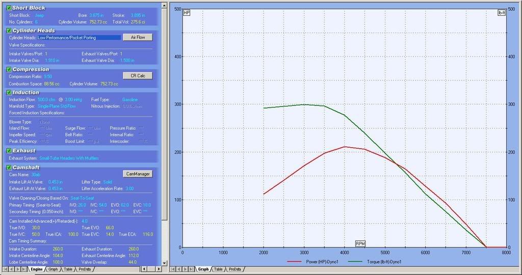

using stock bore, stock 4.2 crank, and the numbers provided, this is the difference i came up with for 30AB and 30AB w/1.7 ratio.
To find the 1.7 ratio, i am doing .453 / 1.6 = 0.283125 * 1.7 = 0.4813125 or .481. I also slightly changed the ramp speed of the lifters to suit the higher ratio. I know Flash uses different settings for the head then i do, so his numbers are a little higher, but for comparison, this is my Desktop Dyno run
Both runs have +4 on cam timing
30AB with factory rockers
Peak Tq = 300 @ 3000 rpm
Peak HP = 211 @ 4000 rpm
30AB w/ 1.7 rockers
Peak Tq = 304 @ 3000 rpm
Peak HP = 216 @ 4000 rpm
30AB w/ 1.7 rockers
