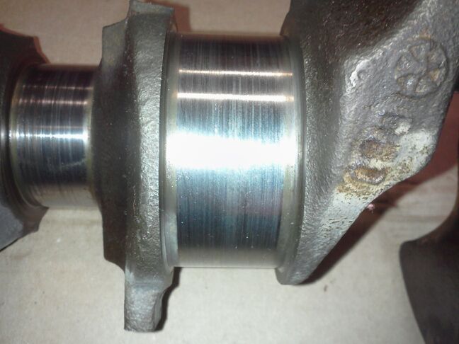

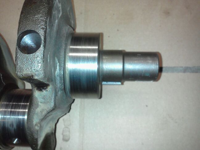

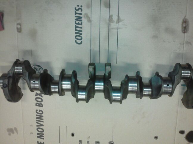

On another note, I got the 4.2 completely torn down and the crank looks beautiful! Couple of pics:

I hope you get that crank checked out and at least polished before use. Some of those scratches don't look like will polish out.

None of the scratches are deep, the pictures are deceiving. The crank is actually in amazing shape. I plan on having it checked however I am very confident all it needs is polished.SilverXJ wrote:You can deck the block to get the deck clearance down. As far as pistons you can get a custom piston with the 4.2L rod, or KB 944 or Bulltear pistons with the 4.0L rod or a 4.0L rod with a custom piston.
