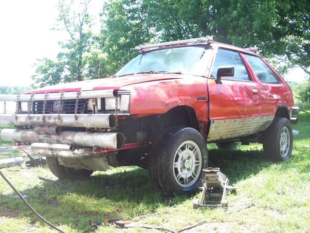

I haven't got it yet. I have done this before with a fuel injected ej22 subaru engine to an ea style 4 and 5 speed 2wd/4wd /low range transaxle. I didn't even need a plate. Just drilled 2 extra holes in the transaxle where needed and shimmed all the way around. I redrilled the smaller ea81 flywheel so the starter fit but also set one up for the ej22 clutch and flywheel... it was a turd. smaller flywheel = faster wind
Last time I ran it I popped something inside the transmission when I was bound up so now it's a paperweight. It had nothing to do with the mating. Here's an artist's connception before someone closes this tangent thread
P.S. now it has a unistrut brush guard with a winch instead of that ridiculous set of horn-rimmed nerds
