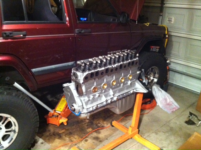

Here's a photo of the long block just before dropping it back in.
