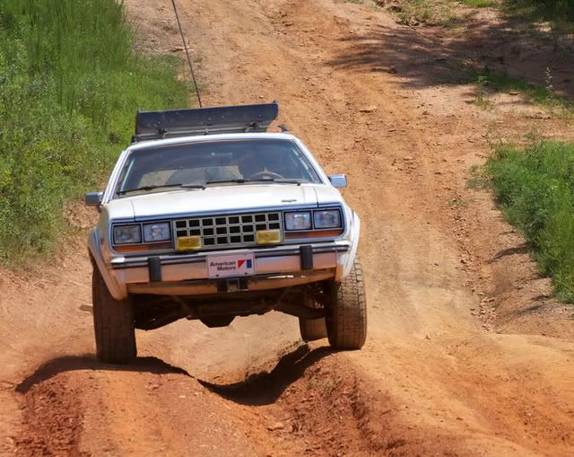

I've been a lurker for a about 3 years and finally seriously considering a stroker. Lots of info here that makes my brain spin. I've searched and didn't find my answer. I have an 86 AMC Eagle with an 81 shortblock with a 4.0L head milled .050, Comp 68-232 cam, with a Motorcraft 2150 carb. I've got over 20k miles on this combo and it runs pretty darn good. I had it dynoed before and after. In Colorado, on a Land and Sea dyno it had 112hp before and 180 hp after. It was a night and day difference but I questioned the after numbers. After moving closer to sea level and monkeying with the carb, it doesn't quite feel as fast or I may have gotten used to it. :huh: I had it dynoed a few months ago on a Dynojet and it was 135HP. The shortblock had 80k original miles on it when I installed it. It has always had an oil consumption problem since installing it. Mostly only on road trips though, since it has a 3 speed auto it revs about 2700 at 70 mph, using about a half a quart between fill ups(325 miles). I have a 4.0L long block that I got for $40. I wouldn't use the head that is currently on the 258 since it is milled and has the coolant passages welded. I do have everything to go EFI via Megasquirt but need the time and sack to do it. Does the .5 liters make that much difference?

Nice ride! :D
Re: Does the extra .5L make that much difference?
6TIME wrote:Nice ride! :D
x2. You just don't see many of them anymore.
