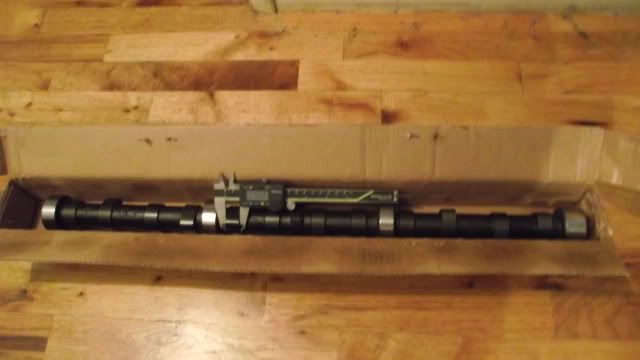

Last week the distributor drive gear in my Wrangler took a big O'l sheit, so needing to get my Jeep back on the road sooner than later I'm just going to patch it back together, I opted for the Melling #MC1376 stock replacement cam for the '96-'99 4.0, just looking at it you'd swear it was an OE Chrysler cam!? it's ground on a "CWC" blank, no identification what so ever, it has NO fuel pump eccentric and it has the WIDE lobes!, I'll post back later on how well the distributor indexes?
As this appears to be a quality part I thought I'd let you guys and gals know, also this cam actually compares rather well to the Mopar Performance cams rather well on the dyno simulations!, more horse power but a little less torque.
