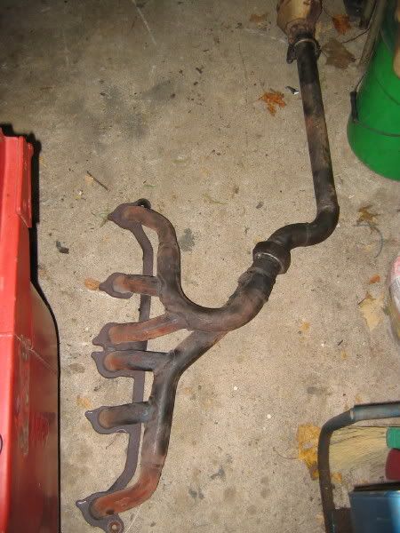

I had been running the OEM header since I did the 4.0 head swap 3 years ago. The tubing was small (1.75" I.D.) and bombed out due to numerous exhaust retrofits, battles with rocks, and general 4 wheeling carnage.

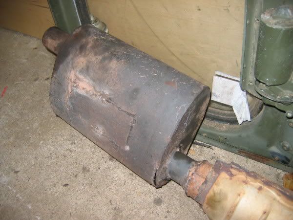

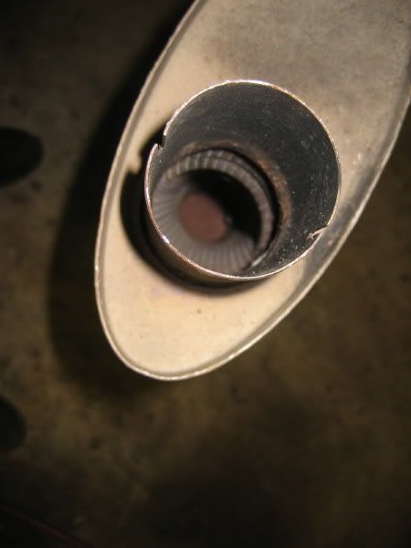

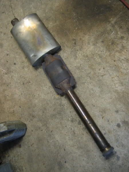

The muffler I had made about 10 years ago out of a old water filled SS fire extinguisher. It has held up very well, and will be spruced up (again) and installed on the Willys.
The new stainless steel header I bought off Ebay for about $210 (including shipping). As far as I can tell it is exactly what Banks sells as their Touque Tube. This is the SS409 model. Pictured below, before I cut the flange off it, laying on top of the old header.

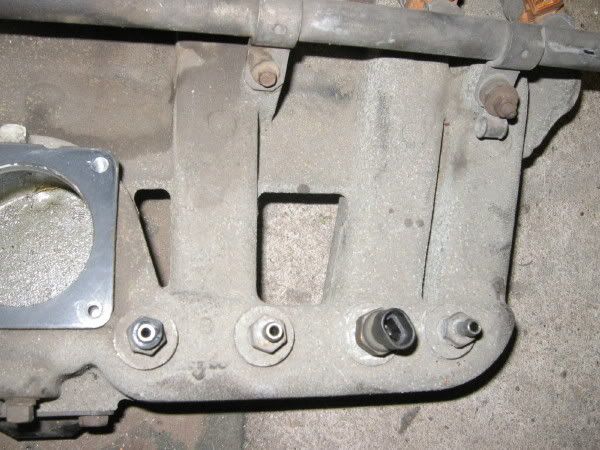

Here are the "new" and "old" intake manifolds. The 'new ' one is (as far as I know) from '99-'06 4.0's. The 'old' manifold is from '91 - '98 4.0's. I have heard a ton of hype on the late model manifolds that claimed a ton of power increase by installing it. You can clearly see the octopus like design of the late model.
the earlier model has the runners branching off each other
the late model has all the runners meeting in the plenum, which is much larger than the earlier models'. The equal length runners to each cylinder gives them all the same advantage as far as air delivery. I wish I had this manifold on my 258 years ago!

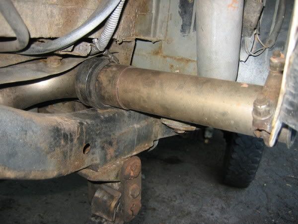

I had a bunch of figuring to do with the exhaust routing, as I was planning on enlarging the exhaust pipe to 2.5" O.D. I first has to cut off the OEM style exhaust flange.
It all took a bunch if times of installing, tacking and rechecking the fit and placement of the parts-- atleat 10 times... here is the final result- the header pipe travels strait down, underneath the clutch linkage. Note the O2 sensor bung.

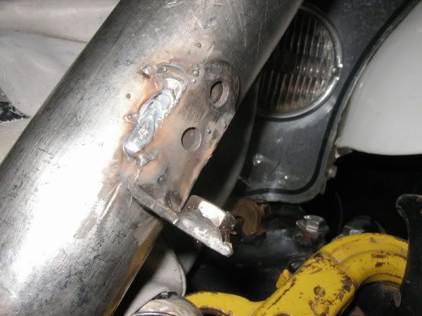

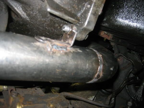

I have installed a hanger on the pipe to allow the header to be bolted to the engine/transmission assembly. I have found this GREATLY reduces the stresses on the header and allows it to remain crack free for a MUCH longere time.

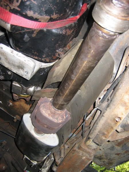

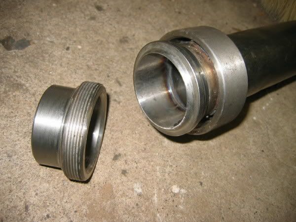

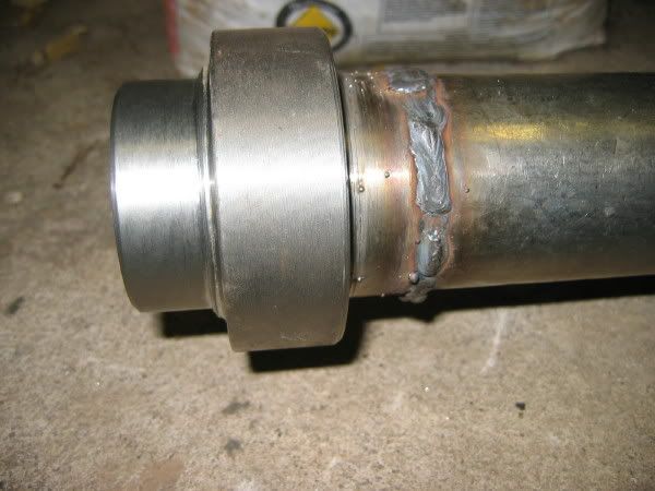

To establish a serviceable joint between the header and the rest of the exhaust, I have grown fond of using stainless steel plumbing unions. Using copious amounts of anti-sieze when installing and then copious amounts of WD-40 upon removal allows for a maintainence free joint. They hold up very well, provide a great seal, and don't require any sort of gasket.
Here is the one that was removed
I have found that the facets on the nut can make it difficult to get the wrench in just-the-right spot, so I turned the new one smooth on the lathe. It will allow for quick work with a chain wrench. :D
For anyone wondering what a chain wrench is.

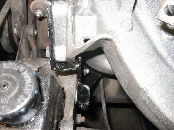

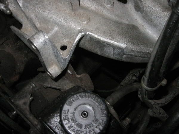

The only trouble spot with the late model intake manifold swap is that the power steering pump brackets don't line up -- at all. For starters, I didn't like how close the one bolt hole/mount was to the power steering pump, so I cut it off and cleaned it up.
I then fabbed up a few little parts, tacked them together in-place, took it off and welded it up solid. I was alittle fearful from what I has heard about this part of the install, but it went quickly and easily.

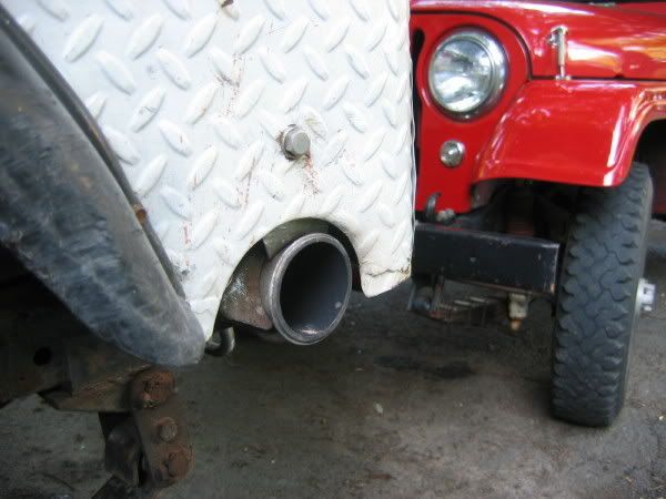

stay tuned for the rest of the install-- the cat ( I reused the one pictured above) and mufler (Dynomax all stainelss glasspack -- ebay $20 brand new!) are together.
As for the performance of it all-- well, it certainly has a bit more throttle snap! It accerates much smoother and has a bit more all through the power range. It was worh the $$, time and materials. I am planning to get it on a dyno some time this winter.
It sure sounds cool.Throaty but not booming. I am anxious to see what an 'unholy' tailpipe will sound like. The tailpipe is slapped on for now-- picks to come of a custom fit model.

Jeep-Power wrote: The muffler I had made about 10 years ago out of a old water filled SS fire extinguisher. It has held up very well, and will be spruced up (again) and installed on the Willys.
I know this is off a little but how do you make your own muffler. :lol:

The SS pipe union is freakin genius ;)

anyway, i love that attachment to the bell housing bolts for the down pipe. good idea i bet it does really cut down on header cracks. why did you decide to go with 2.25" pipe? that sure is a great pic of the intake runners at the plenum.
do you have any more pics of that bracket you made for the PS pump to the new style intake? which PS pump is that anyway?
Well, frst you have to have the desire and drive to do so. At the time I was too cheap/broke to buy a $100 muffler and eBay wasn't what it is today, so the need was there-- to boot, I was sick of replacing mufflers!
The muffler was made by cutting a section out of a stainless steel (SS) water-based fire extinguisher that I found in the scrapyard.
I then 'squished' it down until it was oval in cross-section, like a regular muffler. It hen cut the oval encaps out of SS sheet metal. It was a little tricky, but I got it done. I then drilled two holes in each piece wit a hole saw. The two tubes lap over each other inside-- they are welded together with two strips of SS. Where they face each other, inside the muffler, I cut slots, so air could pass between them. The ends of the tubes were left open. I then welded the entire contraption together. the patch you see in that pic is when I had to go back in and reweld the srtips that were holding the tubes together-- they had broken loose and were making quite a racket!
Thanks! Again, just be sure to use PLENTY of anti-sieze on assembly and PLENTY of WD-40 on dissasembly!

The tubes' ID actually measures out something like 2 3/8. I knew I wanted larger than the 1 7/8 i was running. I forget who, but someone on Strokers Yahoo! said they were running 2.5" tube and were very happy with it. Again, I got the tube from the scarap yard--along with the SS unions. It is what was there to be used.

No-- not too many more pics-- I simply bolted the hunk of metal to the manifild and the the pump to it's mount and set everything in place, as it needed to sit, on the engine. I then fit the small piece to connect them, tacked it in place, then removed it all to weld it up solid. It was really quick and dirty, but plenty strong. The paint took longer to dry.

btw, thats the best solution to bracket problem ive seen so far. looks like a beefy bracket too.
Yes, stock belt and stock mounting location (it didn't move back at all) for the pump (didn't have to change the front mounting plate)

oh ok, i didnt realize this was a CJ. should have noticed your avatar. from what i can tell thats the same PS pump bracket found on '91-'96 XJs. if it is then i wouldnt say that its in the exact same location as stock. it would be higher up in front of the intake. thats why i was asking about the belt size.
does that PS pump bracket utilize a belt tensioner or did the bracket you used originally have a pulley tensioner? i realize you dont need either with your v-belt setup. just wondering about the origin of the parts you used so i can tell if i will have much trouble replicating this on my XJ.

I cannot tell you the simmilaritues of the XJ and CJ rear pump bracket. I cna tell you that thsi one is in it's factory location. It has to be for the front PS pump bracket to work and for the ohter rear bracket mounting bolts to line up with the bolt holes in the block ( in the side of the block, below the exhaust manifolds).
The OEM CJ pump does have an integral belt tensioning system. It is a little tricky to figure out (hidden bolts)! :D

i know what you mean about that thing being tricky. it always need further tweaking after bolting it back up. lousy design if you ask me.
i will be using your design to make that ps bracket adapter. thank you.

that is some pure genius with the exhaust!! i love the idea of bolting the exhaust to the bell housing. i wonder though if someone had, could they put a newer PS pump on the intake, would it line up. i know this is a vbelt setup, but for the serp setups, would it line up properly?
Thanks-- unfortunately I cracked that bellhousing (rectangular hole for the shift fork) and the replacement (square hole for shift fork) didn't have the same bolt hole, so I made a 1/4" steel inspection cover that had a place to bolt the exhaust too.

Here are the promised pics of the cat/muffler assebly and tailpipe.
Dynomax muffler-- you can see straight through it-- that is the cat's honeycomb down there...
installed-- note 20ga stainless heat shield..
tailpipe above axle-- not the best shot...
rear drivers fenderwell
exhaust tip-- up and out of the way (mostly :D ) of the rocks...
