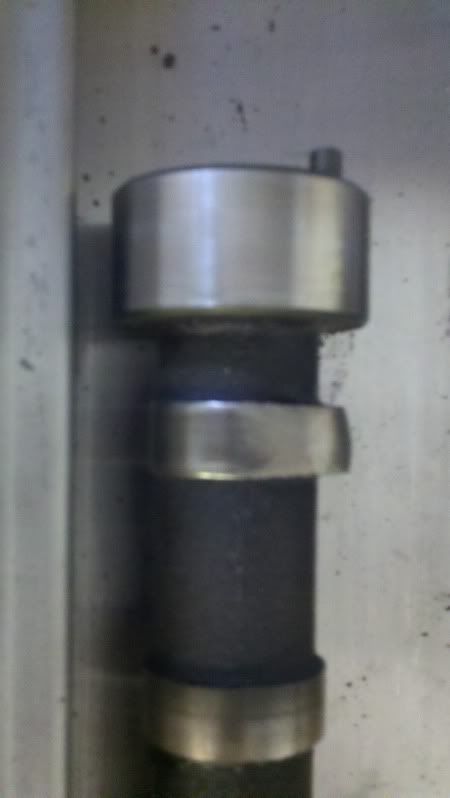

Well got it tore down and its got a flat lobe as well on the cam. So looks like its gonna be time for some work to be done.

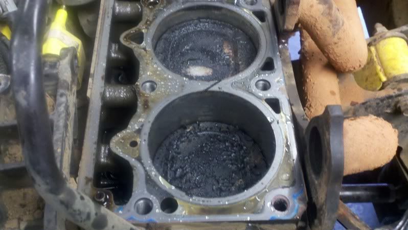

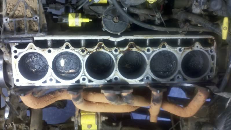

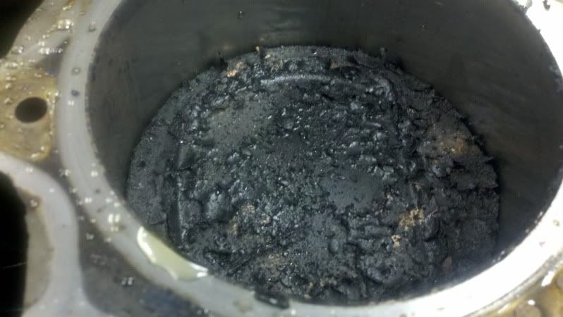

Another comment.. looking at the build guidelines on here it says 4.7 should run a 26lb injector, this motor was built with blue 24's. The top of the pistons have a black "flakey like" carbon buildup. Not sure what to think of the top of the pistons.

Its hard to tell what happened w/o the cam break in knowledge. Possible bad break in procedure.. maybe valve train binding. Maybe just bad cam. What springs are installed? What oil have you been using?
As for the piston top, its normal to have carbon build up on it. Did you have a wideband o2 sensor installed?

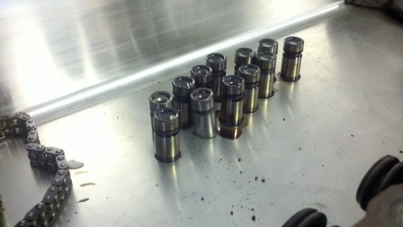

Here are a couple pictures of the damged to cam, lifter(youll see the bad one...lol) and timing cover. Pics of pistons too.

Talked with Mike at Midland Engine this morning. He feels failure was due to to little zinc in oil. Lucas additive I was using did not have zinc help for the mobil 1 sythetic i was using.

If it was a bad break in, the cam/lifters wouldn't have lasted as long as 10k miles. I'd say you either had a bad lifter or a small piece of debris lodged itself between the lifter and the lifter bore. With the lifter unable to rotate in the bore, the bottom of the lifter became cupped and took out the cam lobe. I had exactly the same thing happen to the no.6 intake cam lobe and lifter in my stroker after 34k miles (Crane 753905 cam), except that I also had a collapsed (but not worn) no.6 exhaust valve lifter, so I put my misfortune down to bad lifters. The Crane cam looked perfect except for that one flattened lobe, and I had been using Mobil 1 0W-40 for all but the first 3000 miles.H3RESQ wrote:My biggest question is if I should just order the same cam and lifters again (and other parts??)? I'm hoping it just wasn't broke in proper. Is this a common issue(specific to cylinder 1)? Seems the build was done as per what is said best on this site. So I'm thinking fluke or bad break in. I'll have a couple very able mechanics helping with the rebuild and will follow the cam break in procedure to a tee when I put it in. So hoping I won't have a repeat in 10k miles.
I rescued the situation by throwing my spare old stock cam (already seasoned) and spare old stock valve springs back in, so I only needed to buy new lifters and gaskets. Happily 31k miles later all is still well (knock on wood), and I routinely use an SL rated 10W-40 semi-synthetic.

After talking to a couple guys I know that built strokers I am really in belief that the last oil change when I switched to sythetic and lucas killed the motor. It was its first oil without zinc in it.
One of my friends had the same lifter and cam issue (same cylinder even) when the oils were changing and the zinc was being lowered.

Looks like a lot of carbon on top of the pistons, and with a cat going bad...burning oil or running rich? What did your plugs look like?
