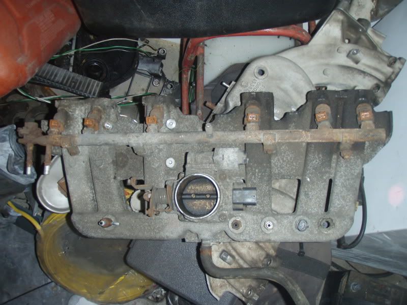

this is the 92 intake

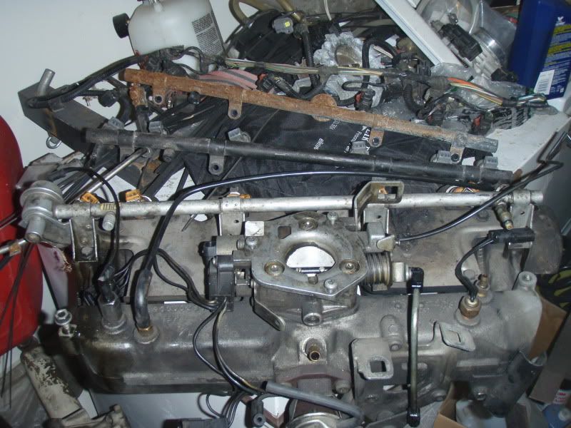

the 88 rail is attached to the intake and the 96 and 99 are in front of it. i just don't know which is which
all the rails are interchangable in the fact any of them will go in the 99 intake but the 88 has different anchor points

All the rails will attach to the injectors. that doesn't make them interchangeable.shawnxj wrote:all the rails are interchangable in the fact any of them will go in the 99 intake but the 88 has different anchor points
The mounting points and fuel line hookups are the differences, that's why i said to use the same "type" lines as well.4.whoa wrote:The renix rail wont fit a newer intake without modification. You should replace the fuel lines with the same year/type lines as the rail you use as well.

ya all the injectors of course fit the rails but i can take the 88 rail and injectors and plug it into the 99 intake. same with the 92 and 96. the injector spacing on all the rails is identical so if i cut the anchor points off the 88 rail it be compatible with the 99 intake

The diaphram in the middle of the later lines is a damper.
What you need to decide if you are staying with the open system or not. Then you need to decide how will it mount to the manifold. That should help you narrow it down.
