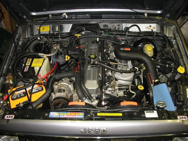

The 2nd XJ aux fan fits in there just fine. Here's how I did mine:
http://i182.photobucket.com/albums/x297 ... 1283102376
Also as Dino suggests, I installed a single row aluminum radiator and a Hesco hi-flow water pump. No problems since with overheating. The cowl hood helps too. :mrgreen:

is that a fuse holder on the pass fender by the battery? and whats the SPAL box for?

amcinstaller wrote:is that a fuse holder on the pass fender by the battery? and whats the SPAL box for?
Yes, it's an aux fuse box I use for the H4 headlamps, power accessories (windows, mirrors, seat, etc.), and electric fans. The Spal controller is used to regulate the electric fan that replaced the mechanical fan. The other electric fan is controlled normally.
