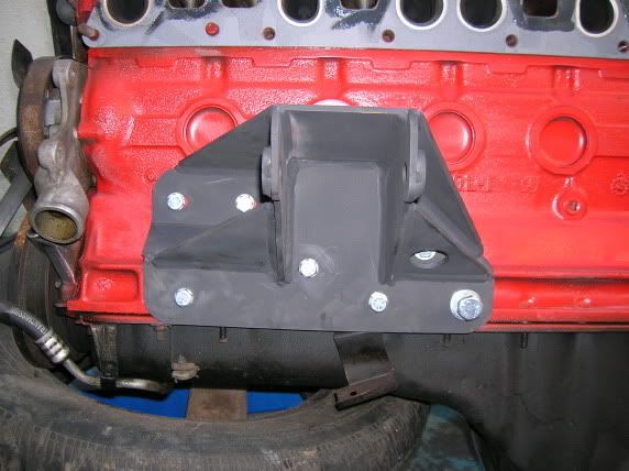

By the way, the MORE mounts will not fit a 2005 block, i assume it is either a Wj or Wrangler block. They changed tie bosses on the block around the 2000 model year. The 3 holes for the mount are basically in the same place, but the height of the bosses on the block are different. Newer blocks use 10mm bolts the older blocks use 3/8. The additional holes used by the MORE mounts may have been moved around or removed, I don't know. Looks like you may have to do some of your own fabrication.

I had an 02 Wj block and was able to use the brown dog mounts for the 00 and up wrangler. I had to throw the bolts away and go get metric ones. Those mounts only used the stock 3 holes per side. I was putting the motor into a 88 Comanche.

I know the brackets your talking about, just helped a buddy of mine put them on his 05 TJ, looked to be good quality, but not what I need, and the Brown Dog Super Kit isn't really what I need either
Left bracket features seven bolts, four more than the original. Right bracket features four bolts, one more than the original.
Where as M.O.R.E.:
We have come up with a replacement bracket that will bolt on using 7-8 existing threaded holes on the side of the block.
Since I'm already working two bolt holes short, I really like the idea of 4-5 more than stock, rather than 1-4.
Just got off the phone with M.O.R.E., and they do have brackets for the late model block, unfortunately it's going to run me about $400 for the engine brackets and motor mounts, I'll have to sick my buddy on them, he has an amazing ability to get killer deals out of a lot of venders.
Also, found this in the PDF file for the engine bracket instal instructions:
The BBXJ9101 Block Brackets are designed to fit the following Jeep® vehicles: 1991-2001 XJ Cherokees equipped with 6-cylinder engines (4.0L ). These Brackets will work with the OEM motor mounts along with most Aftermarket Motor Mounts.
