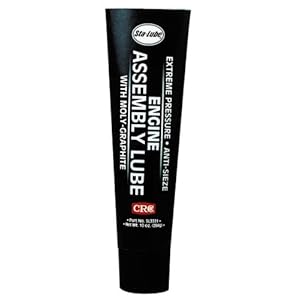

If your AC cam came with lube in the box it is a fluke, I have yet to receive one in any of the ACs I have received. Is it a grey container in a plastic bag? If it is included with the cam then that should be the right stuff. Something else is that according to your date sticker it may have been early enough to sneak through. I will have to see if I still have a box here to compare dates.
Re: Muad'Dib 4.7L stroker build
Usually the moly based lube that the cam companies want you to use is a dark grey paste.

I just checked again and your right it didnt come with any lube... dont know what i was thinking..
Anyhow, i have a bunch of this in the garage:
http://www.amazon.com/CRC-SL3331-Extrem ... B000M8RYUE
Is it any good to use for the cam and lifters? Or should i stick with buying that comp product you guys linked above?

Your best bet would be to call Mopar Performance direct and see what they say. That may be fine, but you do not want to rebuild a second time over <$20. They will know what will and will not work on that setup.
