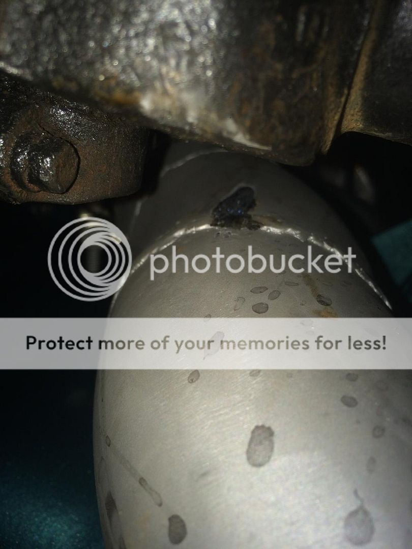

It never ends! I cant just enjoy things. So the new alternator is on and it is working wonderful. Well it's putting out 14.5VDC so I guess that's about as wonderful as they get. I discovered that I only partially cleared my driveway of ice and had previously removed the vacuum lines from the 4x4 system. The thinking there was to remove variables, heaven knows I have enough. So I got stuck in the ice with my open diff under my garage door. That's really awesome in my super BA jeep. Shoveled and chipped for almost an hour, finally decided to just hook up the 4x4 system vacuum leak or not. Then finally took it for a test drive. Great throttle response, in fact almost too much for the weather. I immediately noticed when I slowed, break or otherwise dip the nose, I got this odd sound. Best way to describe it is a chainsaw cutting down a chain-link fence. I nervously turn around and get the heep back in the garage. I hadn't a clue what it was I afraid it was the transmission, after I had added a cooler. Here's what I found.
It looks like all the effort I went through to removed the factory "Dent" in the down pipe was rewarded by my front drive shaft self-clearancing on my new down pipe. I don't have a plan of attack for this yet. AND I've still got to do ball joints. Lame!

Yeah. When you remove the "crush", you must also sweep the headpipe back sooner than the stock one was.
