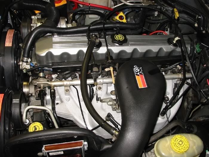

And once again Comanche91 that is the cleanest engine bay I've ever seen in an MJ...

Thanks 1bolt. All I need now is steel a cowl hood. You must be tired of yours by now, no?1bolt wrote:And once again Comanche91 that is the cleanest engine bay I've ever seen in an MJ...
