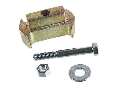

Re: Securing crank while torquing flex plate bolts?
This.
http://buy1.snapon.com/catalog/item.asp ... ir=catalog
