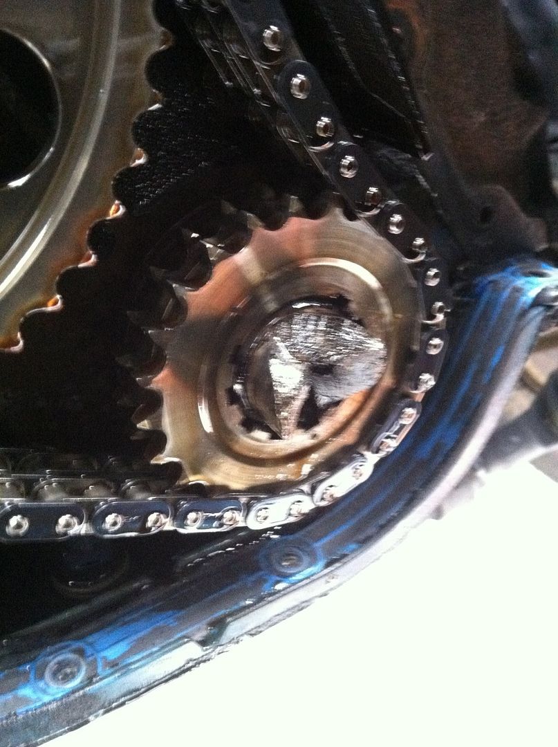

My first crank's snout snapped shortly after a harmonic balancer separated. I was stranded at night and did use the bolt to pull in the new hb, which partially stripped the first few snout threads. I then used a too-long bolt with washers so I could engage more of the snout's good threads. I suspect I bottomed out the bolt. It was fine for a few months, until I downshifted into 3rd while racing a GL-450 and heard the clunk of the hb leaving. Luckily, I had a spare crank. Anyhow, not an issue to be worried about.

That is what I was picturing for breakage. Drilling further into the crank another 2-4" and then thread in a long stud, like a head stud.
The above breakage wouldn't have happened with this longer stud in place.

Basically I was at fault for the snout snapping. It is not an issue and you could very well weaken it by drilling it. Focus your energy on other parts.
