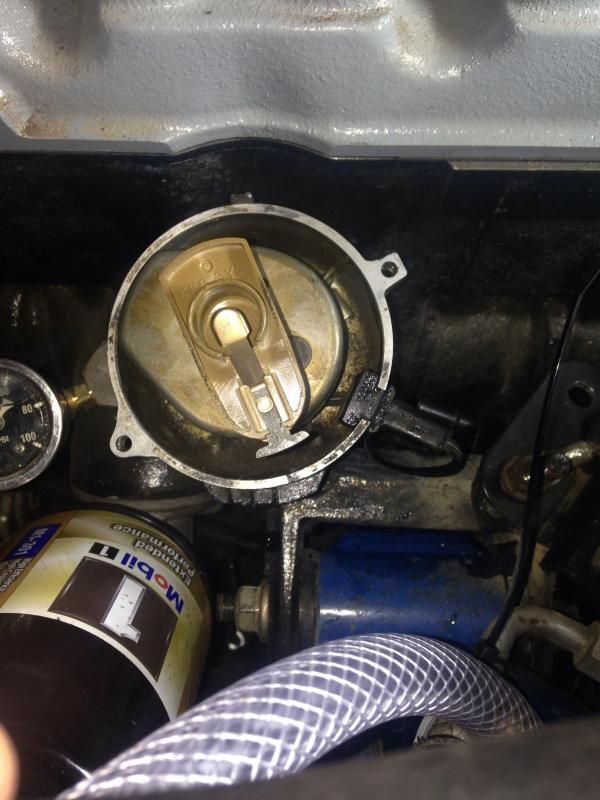

So I've tryed numerous times using Dino's angelfire write up and I cant get it for the life of me. My cam is aftermarket, mopar 229.
http://www.angelfire.com/my/fan/dist_index.html

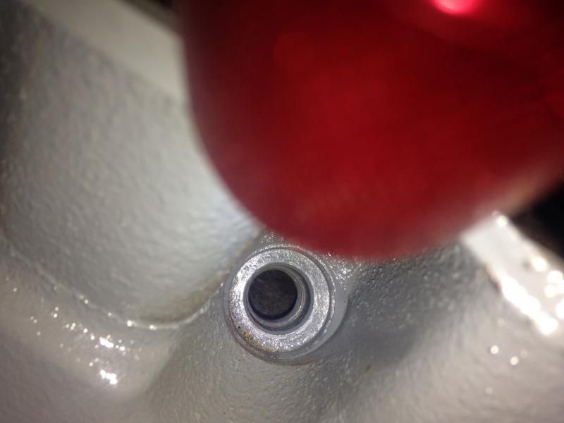

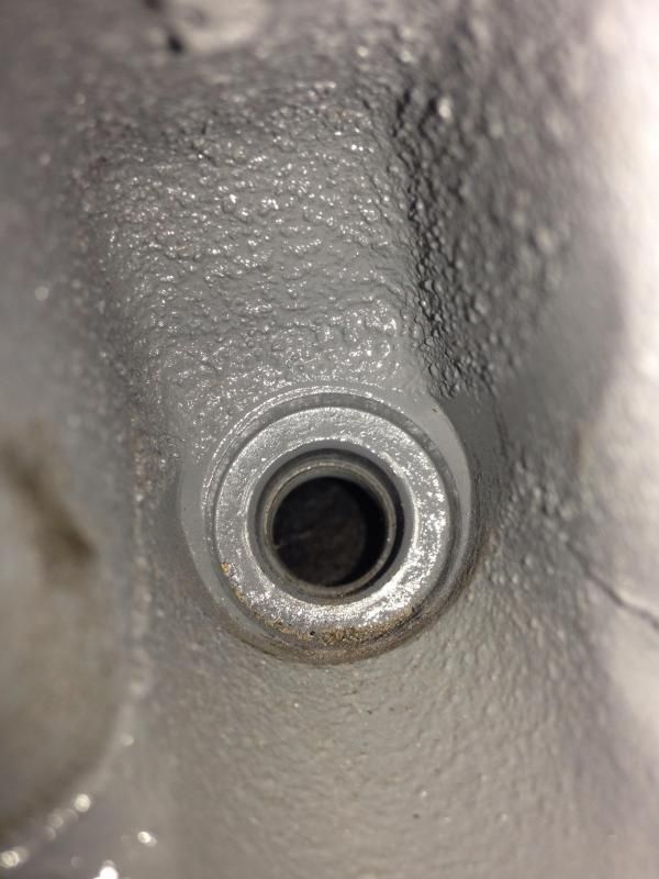

My harmonic damper doesn't have any marks to line up at 0* on the timing cover :huh:
Its hard to make out but #1 piston is at tdc. you can see some casting marks through the spark plug hole.

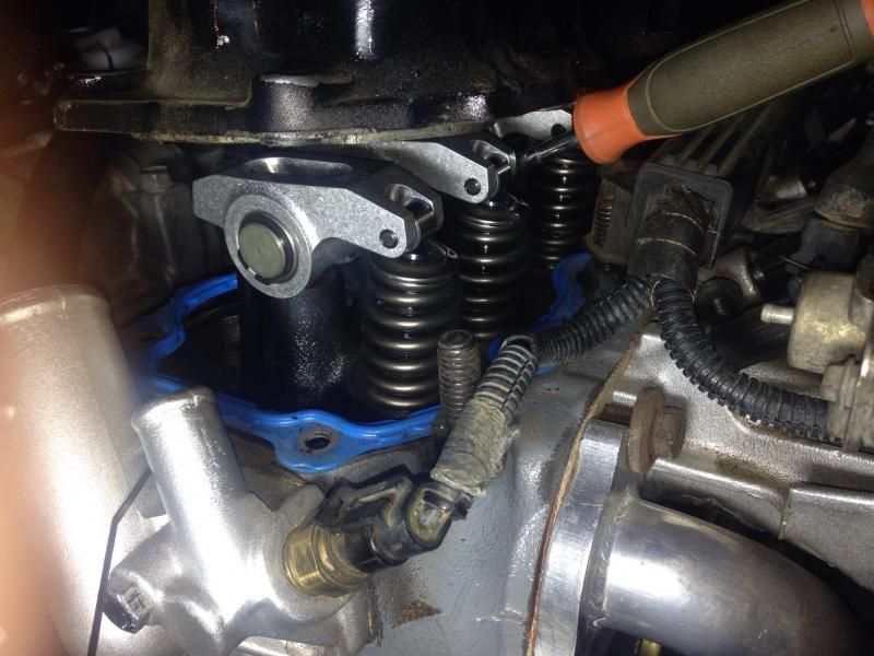

Screw drivers propping up the valve cover. Piston still at tdc. Both valves relaxed? End of compression stroke right?
Black line is 3cm from rubber plug. When standing at passenger side, the rotor is pointing around 730-8ish. Not 5 o'clock like indicated in the write up.

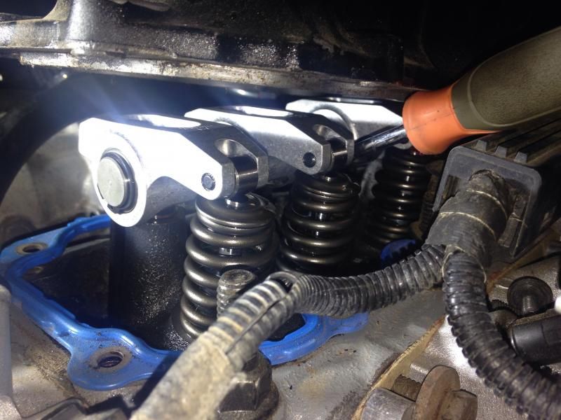

This time I watched the valve events. Intake opened, piston going to BDC. Intake valve closes, piston coming to TDC. (Compression stroke) both valves relaxed.

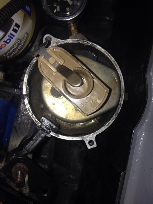

Looked over and saw this. Please tell me this is right lol. Black mark Is #1 plug. About 5 o'clock when looking at it from the passenger side.
Posts: 3270
Re: Need major help indexing distributor.
Yup. Looks like you've got it nailed.

When you pull it out note where the rotor is pointing.
If I remember correctly the slot should at 11 o'clock (pump drive).
Put the slot to 11 o'clock, reinstall the distributor with the rotor set where it was at removal.
Then with the engine at TDC, slide the distributor back in While twisting, and you should be back at your black mark.
