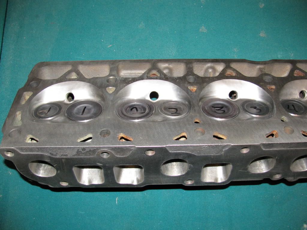

Removed the small quench shelf, sunk the speed pro valves, got 68cc's. This also makes the plug a little more centrally located. It's a hemi now, lol.

Another side benny, the head weighs less than an aluminum head now... :lol:
