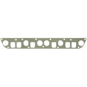

When I originally built the motor, I ordered a full Victor Reinz gasket kit for it. Every gasket was correct, except for the intake \ exhaust gasket. Apparently, my 99 block / head is a bit of a Chrysler bastard child. The gasket that it came with fits the intake ports mostly properly, but the exhaust is way off. The holes are square or "D" shaped and actually blocks off a solid 3/8 of the bottom of the exhaust port on the head. I ran into this problem once before when I installed an aftermarket header. It came with one of those ultra cheap pressed gaskets, I didn't like it, ran up to the parts store and got a Felpro gasket for a 99 Wrangler. The one I bought didn't fit right and of course the parts store was closed. So I used the cheap one that actually fit properly.
On this build, same deal. The VR gasket (stamped 17941S) covers up the exhaust ports. I ended up with a Felpro MS94970. It has round exhaust holes that don't restrict the exhaust ports. According to Rock Auto, that gasket is used on 91-98 4.0L motors. Doing a little detective work, I pulled up the P\N for a 1998 Victor Reinz exhaust manifold; MS16120. A Google image search shows the MS16120 looks just like the Felpro MS94970. The P\N reported for a 1999 Victor Reinz gasket is MS16315, Google shows that as being the "square" holed gasket that my kit came with.
The Victor gasket is a MLS gasket, with the intake portion being a single layer of steel. The exhaust portion of the gasket is made up of two layers of steel. Each section is cut to fit around the other and riveted to each other. Each of the intake and exhaust ports are "beaded", IE they have a ridge that runs around them. The Felpro gasket is a steel core with some sort of fiber laminate on each side. I have always had bad luck with exhaust leaks, both at the header as well as at the gasket on my 6cyl Jeeps. Even after following careful FSM torque procedures, they still leak. My question is, what gasket type do you prefer for intake and exhaust? The multi layer steel Victor gasket, or the fiber laminated Felpro? I'm ordering a full gasket kit, again for my rebuild and I have to order the intake /exhaust gasket separately, so I can go either way. Opinions?

Felpro MS94970 (91-98 4.0L, also 99 in my case)

I have ran into this alot and MOPAR screwed up for some reason or another with the 99's and used the wrong (00+ intake/exhaust) gasket when they should have used the Proper 91-98 gasket...
I would say go with the Felpro Gasket as that is what I use most and find it to be better or get a custom MLS Gasket made which is what I will be doing for my Storker...
Re: Cam failure, partial rebuild. What intake / exhaust gas
Use the correct VICTOR gasket, I throw the cardboard Felpro's in the trash!
I always used the Felpro and never had an issue with it. I'd do with that as there is a bit more meat to it than just simple steel. Plus it has large rings on the exhaust ports. Its definitely not cardboard.
