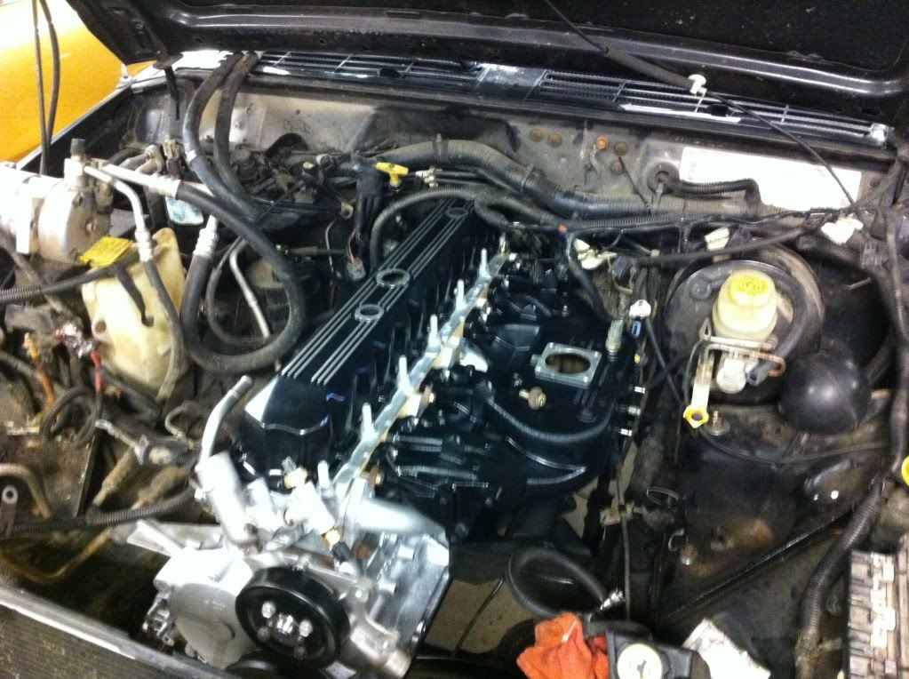

my recipe is below. It hasnt thrown any codes and seems to be running great. below is some pics of the process and some videos of is running (sound isn't that good cause its from my phone)
92 block bored 30 over deck height .010
258 crank
258 rods
sealed power 30 over stock 4.0 pistons
mopar 29ab? don't have the number handy but its the one with 248 duration
stock 92 head reconditioned with stock size valves, cleaned up the bowl and gasket matched the exhaust/intake ports
rugged ridge header w/high flow cat and flow master muffler
99+ intake w/KN filter
stock ECU
.048 head gasket
Hesco 24# injectors
eliminated the clutch fan and replaced it with a derale 2200 cfm electric fan controlled by a additional temp sensor that i added
when I ran it on the calculator I came up with SCR of 10.23:1 and DCR of 8.94:1 with a Quench of .058

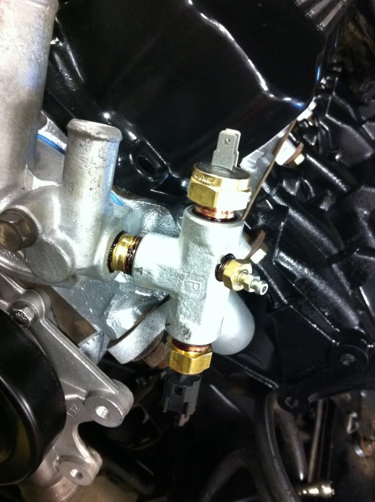

here is the t-fitting where I have both the stock ECT and the aftermarket one to run the e-fan

sounds great , just curious as to what grade fuel you are running? I have my stroker at the the engine builder/uncles place waiting for him to get time to get it assembled. I am on paper at 9.2 scr , .053 quench and i believe around 7.9 dcr. How are the 24# injectors working for you? does it seem like it is on the rich side? Btw I have a 1998 with the obd11 ,what year are you using?

I am running 92/93 octane fuel, might try the next step down in the future but it doesn't really bother me. The injectors seem to be right on the nuts so far.

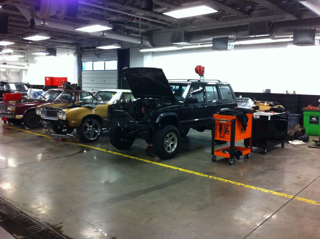

its a 70 Buick skylark that doesn't have a motor in it right now so its riding a bit high in front
amcinstaller
Posts: 635
Joined: May 22nd, 2008, 11:57 pm
Vehicle Year: 1980
Vehicle Make: AMC
Vehicle Model: Spirit
Location: Red Deer, AB, Can
Re: its done and running great
Post by amcinstaller »
ah. i noticed that too but was worried it was so high for those big wheels
