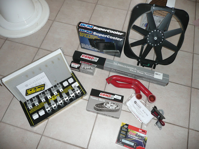

The full goody bag.. new novak fan, silicon hoses, cam, lifters, timing chain, adj roller rockers, transmission cooler, scangauge and engine watchdog

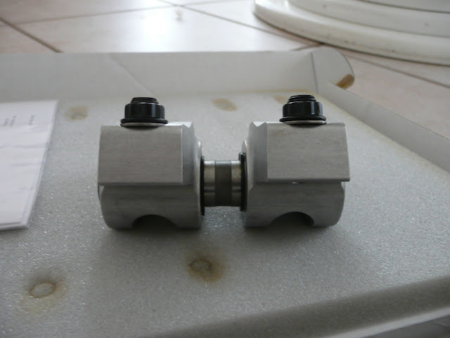

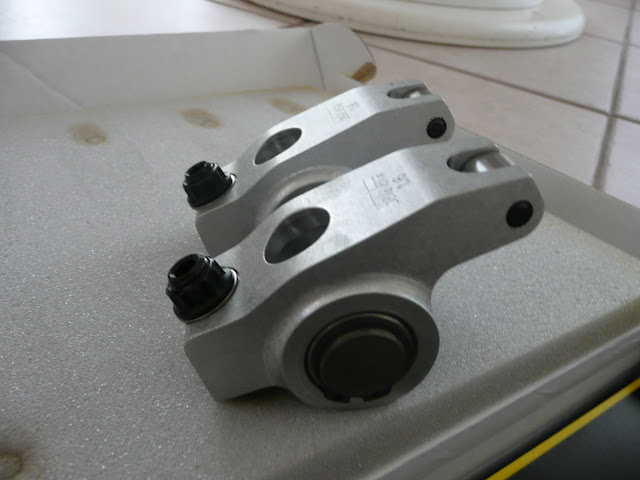

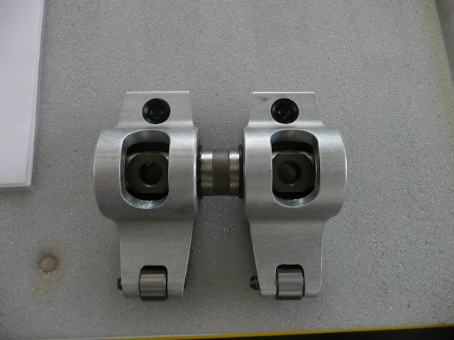

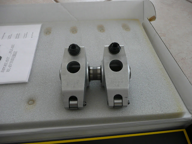

Maybe someday I'll own those Yella Terras. . .
Re: First Stroker ... 4.7
Wow.. they look a lot different from my Yella Terras... not just the adjusting part either.
They were the single most expensive part of my build up... $664AUD excluding freight
. That cost about $20AUD to have them sent from the other side of the country. Pricey, but I wanted them. They are not stocked anywhere either so I called Yella Terra direct and they still had the design so they made them up for me in a couple of days. Part number YT6328.
