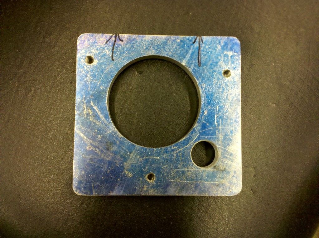

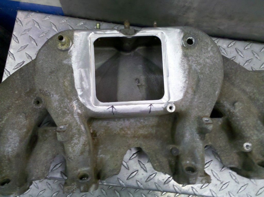

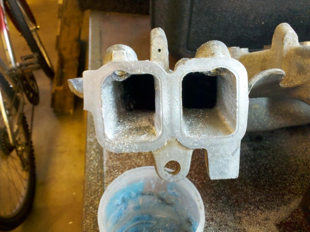

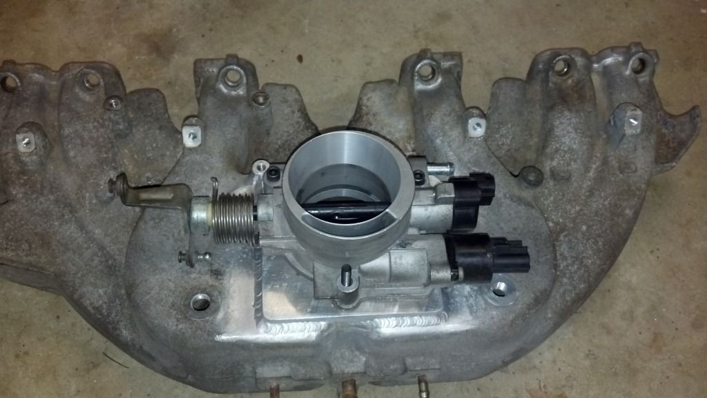

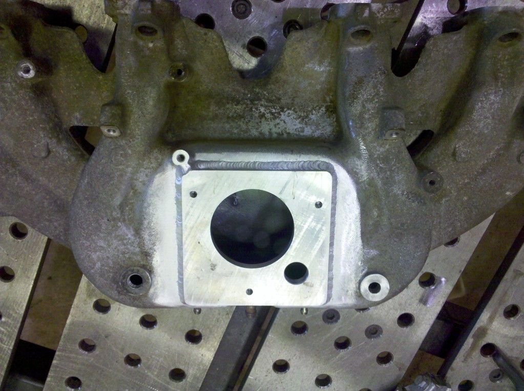

Next, I really want a larger TB but im cheap so i wasnt coming off the $500 for one. Went to the local P&P and gots me another WJ manifold and Durango 63mm TB. Im a machinist by trade so the next few steps where easy. I ported the manifold:
The next step was to adapt the Durango unit to the WJ manifold. I had a few ideas but this one seemed best. I made an adapter plate and milled a pocket in the mani to be welded up.
The idea was to have the centerline of the old throttle blade in the same location as the new one so i could reuse the throttle cable. Long story short: I trashed a bunch of stock TBs to "make" a new TB shaft/pulley and was NOT happy with the results. Back to square one..... One day Ill revisit this idea but for now its under the work bench. I got to looking at an aftermarket TB and realized it looked a heck of a lot like the stocker. A hand full of measurements confirmed that the stocker can be bored out to 6x.xx". The biggest problem was id need a new throttle blade. But hey, How hard could that be!?

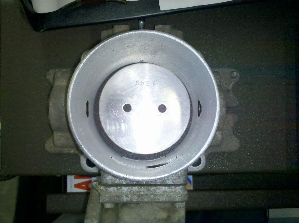

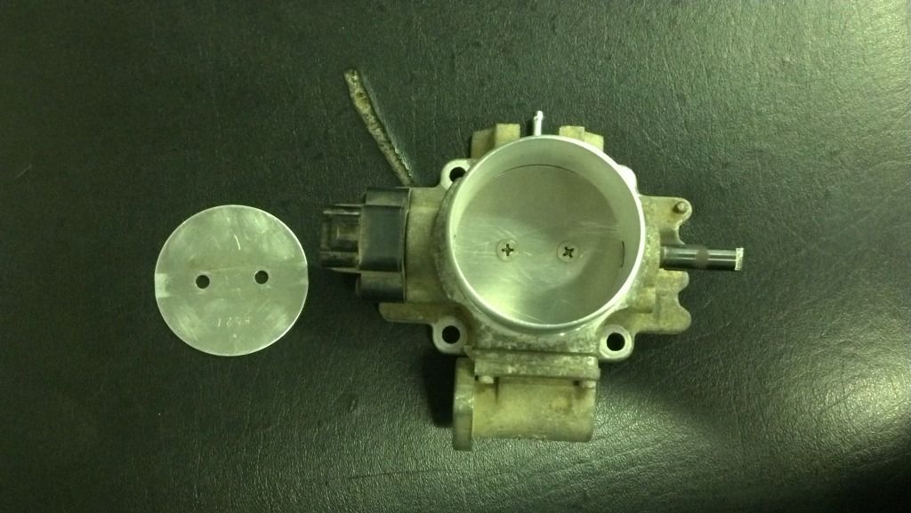

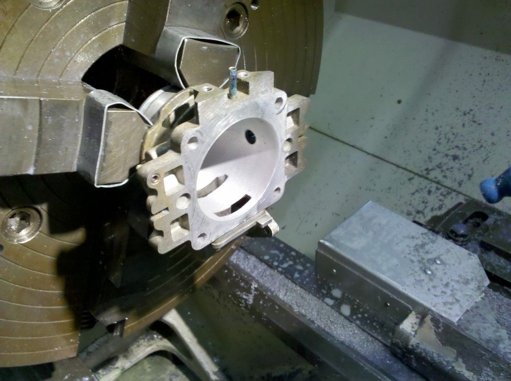

First, i started again with a stock OBDII TB, disassembled it, and flung it in a lathe.
Exhibit A:
Truth be told, i think this could be taken to just under 65mm but its cast aluminium, made by the lowest bidder, so i wasnt taking the chance. The intake tube clamp area gets Uber thin(~.07" IIRC), so 2.500" sounded nice and round to me! :D
A pic post-turning in my favorite lathe with the stock blade in it:
Ill post up some more pics and info tomorrow. Lemme know what you guys think so far, better yet i love some ideas on the durango TB.

So the next big dilemma with the throttle Body is the throttle blade, when closed, it sits at ~10* angle inside the bore. This angle is critical for about 100 reasons but the top two that come to mind are TPS voltage and the shaft arm. My universal scan tool doesn't read voltage for whatever reason but it does read percentage, so whatever, a number is a number. The stocker registered "14.7%" at idle. The shaft arm needed to end up at the same angle so the setscrew/stop would function properly. Sure theres adjustment but not much. Ok, enough of the reasons, how do you plug a round hole at an angle? With an oval! I don't have any pics of the fixture i made to make the blades but ill describe it as best as possible. Its a 3x3x1 block with an angle (10*) cut in it. Horizontally, in the center of that angle i drilled and tapped to 8-32 holes. These were so i could bolt a 3x3 sheet to the fixture for milling. The sheets then went in a mill to have the holes/countersinks placed in them. I need to get a pic of them as well. Anyhow, with the plate at an angle, i milled a 2.500" circle vertically around the center. Viola! The TB shaft had to be heavily modified, which you can kinda see, but the long and short is, I cut the top of the slot off and widened "seating" area. Locktight is a must here! On the the pics:
Assembled on a spare shaft:
Old inside of new:

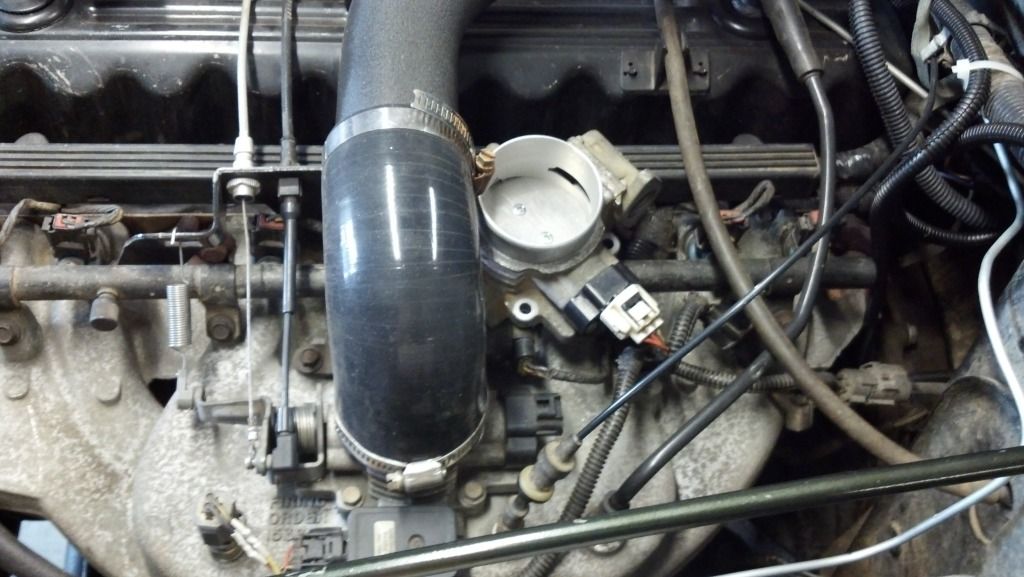

I've got plans to make my own 62mm TB from a few spares I have on hand. I wsa going to use the same method to mill an angled mounting base to support the base as well. What method did you use to get the circular cut made though? I'm planning on mounting the support block in a rotary table and find the end mill edge distance from center then just turn it 360 degrees to make the cut. Is that how you did it?
Posts: 1516
Re: The evolution of a 2.50" (63.5mm) Throttle Body
Dodge Dakota TB on mine... kind of a bad pic, but basically the Dakota shaft was used and a proper throttle end was retrofitted onto the Dakota Shaft so that the TV and Throttle Cables can attach to it properly. The only current thing that bugs me but doesnt seem to cause a problem is the angle of the TV cable from the mount to the TB connection... but it never has been an issue. (Might fix this someday)

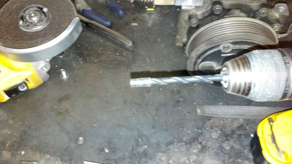

im trying to figure out why you had to cut the throttle plate rod like that. the widening of the slot makes sense, but why cut the "top" section out? what thickness of material did you end up with?

GoMopar440 wrote:I've got plans to make my own 62mm TB from a few spares I have on hand. I wsa going to use the same method to mill an angled mounting base to support the base as well. What method did you use to get the circular cut made though? I'm planning on mounting the support block in a rotary table and find the end mill edge distance from center then just turn it 360 degrees to make the cut. Is that how you did it?
With the plate at 10* angle to the table i placed it in a CNC mill and "cut" a circle. Worked 10 times better than i thought it would have. My other option was to put it on a bridgport with boring head and work my way in from the outside of the plate.

amcinstaller wrote:im trying to figure out why you had to cut the throttle plate rod like that. the widening of the slot makes sense, but why cut the "top" section out? what thickness of material did you end up with?
I didnt have a hacksaw blade or file thin enough on hand to fit in the slot and widen it so off it came! Besides it was just taking up room in the path of that valuable airflow.

Muad'Dib wrote:Dodge Dakota TB on mine... kind of a bad pic, but basically the Dakota shaft was used and a proper throttle end was retrofitted onto the Dakota Shaft so that the TV and Throttle Cables can attach to it properly.
After looking at yours 20 more times it looks like you kept the stock dakota arm and placed a stock arm to that so you could retain the dakota return spring. Right or wrong? More pics prease?!?
4.7 Stroker, AW4, Dana 60, 14Bolt, AtlasII 4.3, 104"Wb, 40" Nittos on Walker Evans
Posts: 1516
Right... made it simple.
