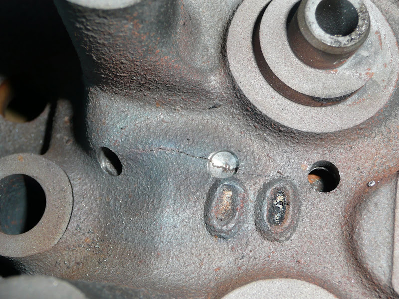

Here's mine, from a 2001 TJ. It lasted roughly 90,000kms (about 55,000mi). It was a difficult find because the symptoms were not that distinct, I was losing water but could not find any leaks and the car would occasionally get hot on a crawl or at idle. On a couple of occasions the car would stall but so inconsistently it had me baffled. I had the cooling system serviced and checked numerous times and replaced quite a few components; it was only until I had a combustion leak test done by checking for exhaust gases in the radiator that a very slight amount of gas was detected. I instantly ripped off the cylinder head and found some yuckies.
At first it just appeared to be a blown head so I sent it into the machine shop for service. They found some damn nasty cracks as you will see below..
Water in the head and obvious signs of a blown head..
The machine shop found these cracks after I asked them to take a look at the head and open up the ports a little bit with some mild porting..

Wow.. usually the crack between cylinders #3 and #4 but that thing just cracked all over. What were your engine temps?
