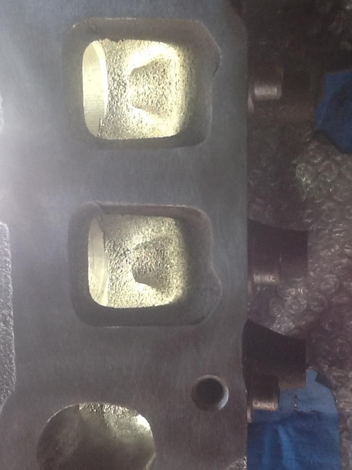

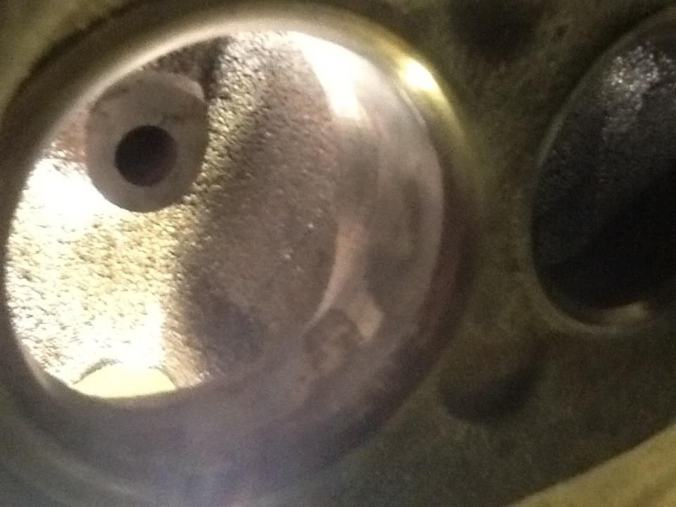

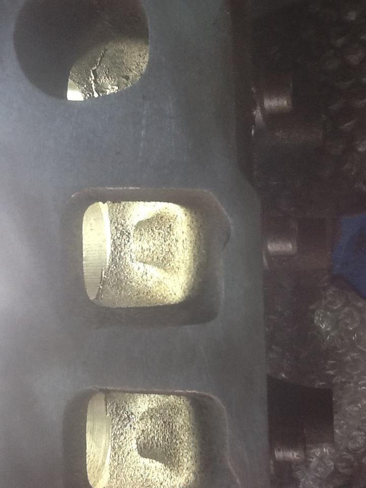

Alright guys I promised pics of the head porting....bear with me as my iPad seems to not take the greatest pictures.
I've got about 2 hours in at this point, just roughing things in place. Also not gasket matching yet as my gasket & intake manifold are in the mail :smack: so runners and chambers only.
Before
Lots of roughness and ridges
After just using bur at this point
Just those few as I hate this dam iPad camera.
Some questions now. On the SSR, should I be flowing the edges I guess you could say?

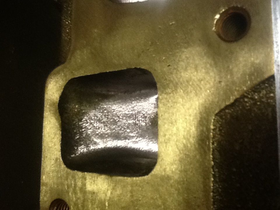

(Upside down but straight view) there's a ledge on the right side of the intact port not very big but a ledge there..should I blend that in, how the runner curves?
Re: Few questions on some DIY work.
Desertjr wrote: Some questions now. On the SSR, should I be flowing the edges I guess you could say?
Yes, Just smooth everything out, removing any sharp spots. Don't change the shape of the SSR too much. Of course its ok to change the guide shape, make it more tear drop like.

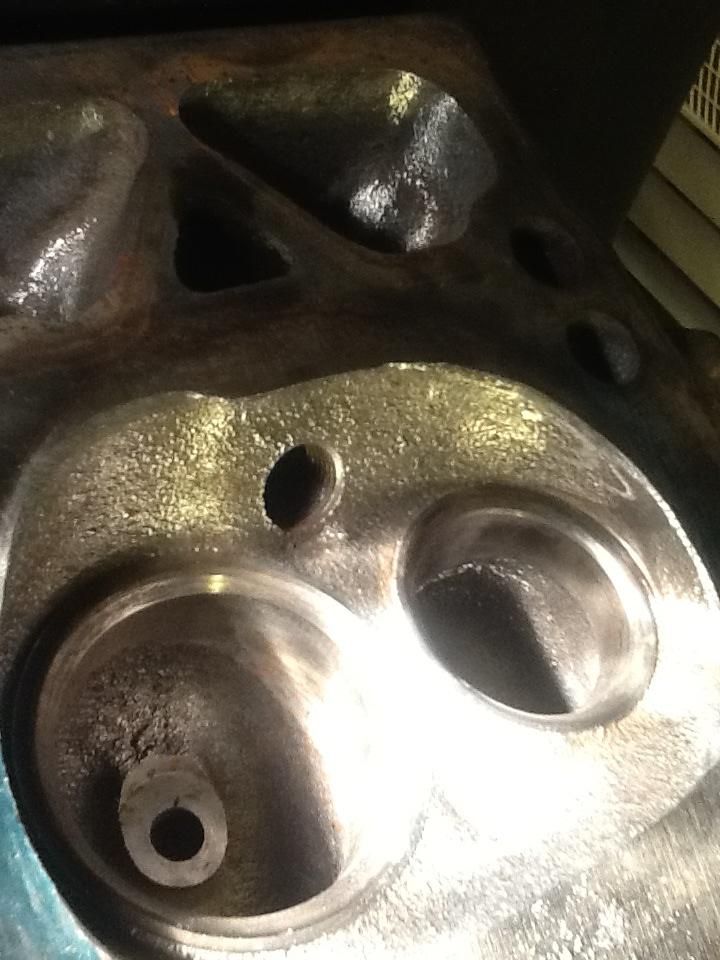

Sounds good. I think I. Did pretty well on my. Intake guides but kinda flopped on the exhaust guides, rounded them a bit much I think. Ill post pics in a minute, not too much but more than I wanted to I should say. :doh:
Using a bur with a 6" shank, so all the exhausts were hard to get at....should of never got a 6" one lol. Gonna end up cutting mine down to 3" or so.
