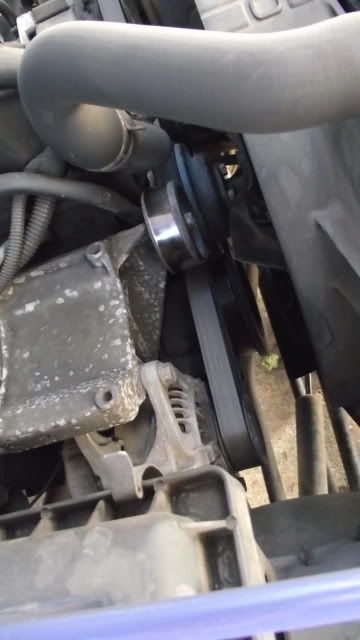

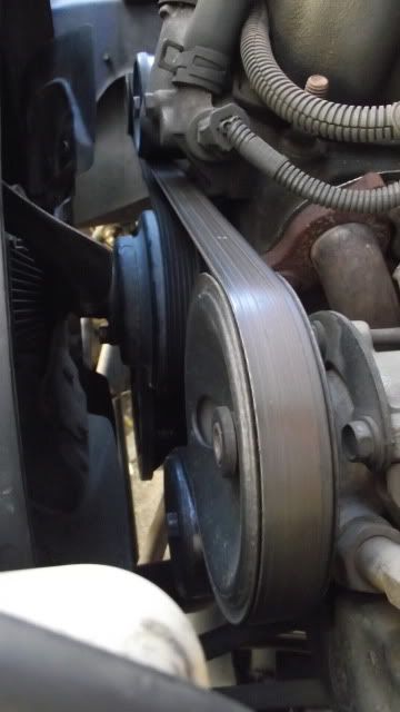

Thanks. I wonder if I have to put in another pulley for the AC or just get a belt that was made for a non AC rig??

mount all the acc. you plan on running and take a piece of string (non stretchy) and wrap around the pulleys the way you want to run the belt. then take a measurement and go get a belt that length. they make all sizes. just tell them thats the size you need.
PS make sure the tensioner is somewhere in the middle so you have some room for error

Yes,. XJs have electric and mechanical fans. However the difference is that the XJ has a separate fan pulley where the TJ's fan is on the water pump. I would try to use as many TJ accessories as possible. If that is even possible given the block you chose.

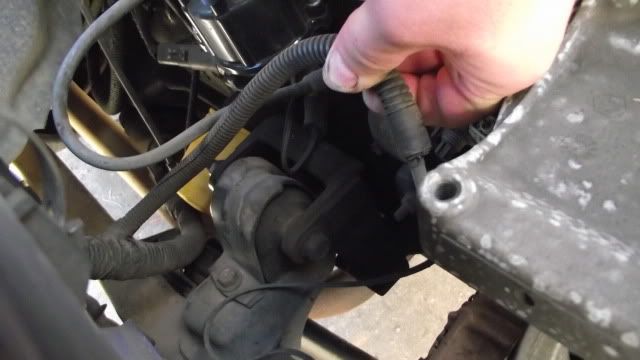

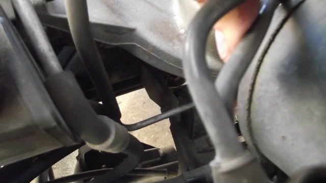

Here's my '97 TJ withOUT AC, and the late intake showing the PS mounting (ALL TJ's are the same) and motor mounts and oil filter, only the exhaust is different on mine, it has a header where yours should? have the two piece cast iron

You mean this correct? If so, we're in business.

The photos with the exception of the late model intake are 100% factory for a '97 TJ, the water pump, radiator and header have been replaced but with stock replacement parts, the only other bolts that have been removed are th oil pan bolts when I replaced the oil pump and pickup tube, all others are as JEEP installed them.

No, the that is the engine side bracket. I am talking about the holes in the block where the bolts for the mounts go.
